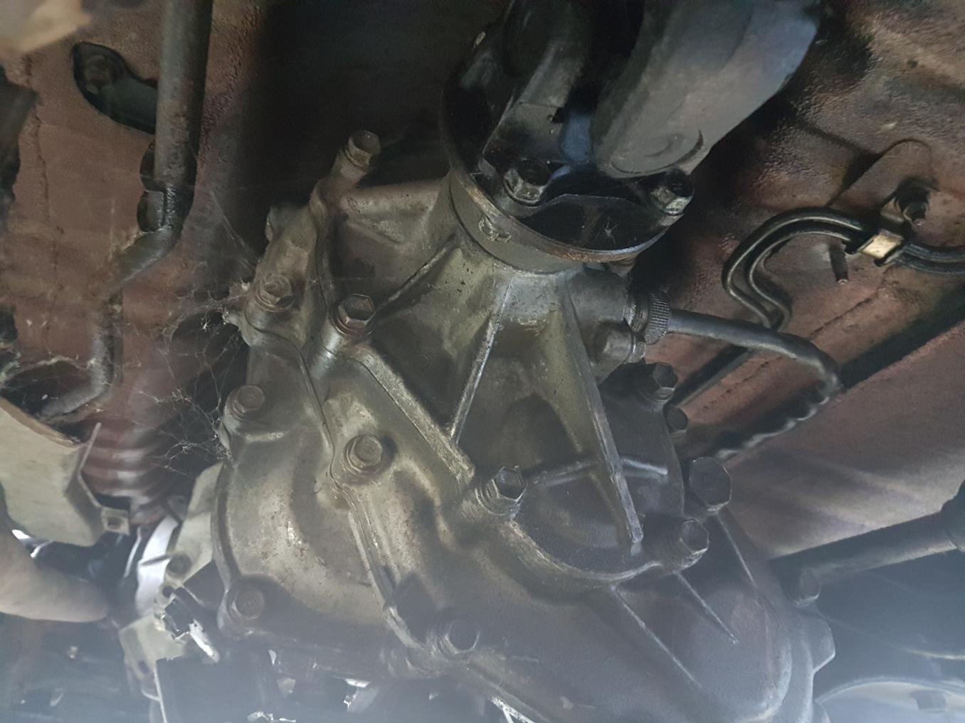

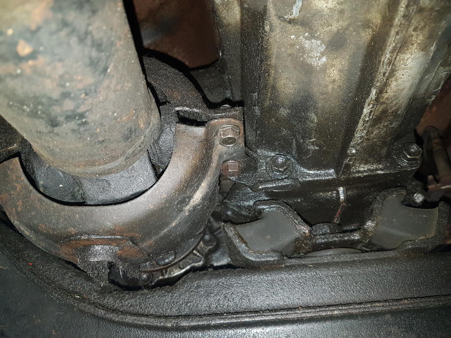

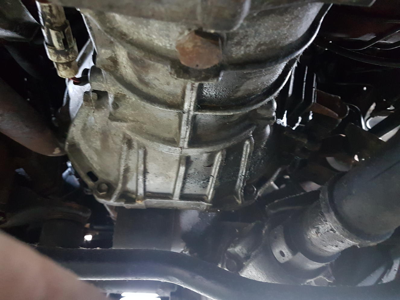

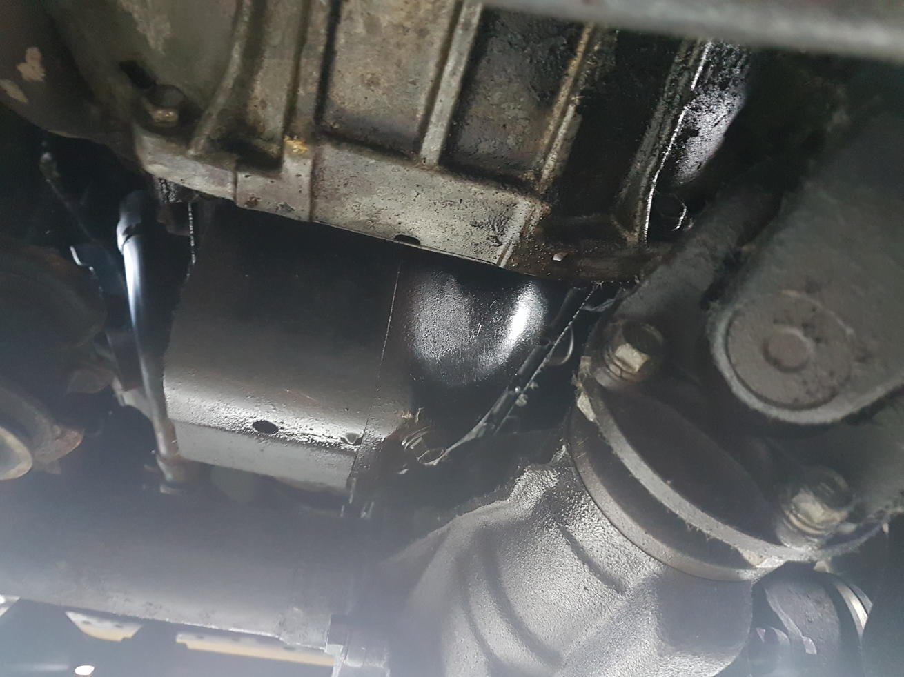

Besides that, under it was leaking oil in everywhere, please, see the photos:

As far as the oil leak goes, reach down behind the top of the motor and feel the bell housing - if there's oil there, you've got a valve cover leak, easy stuff to fix, do it at the same time you lash the valves. Reach underneath the front of the motor for oil underneath the crank pulley - oil there means a bad front main, a little more involved but easily fixable in a couple hours with basic tools. If the front of the motor and the top of the bellhousing are clean then it's probably a rear main leak, which is more problematic and involves pulling the motor or dropping the transmission to fix. That all assumes the leak is motor oil - could be ATF too.
Honestly, that truck looks rode hard and put away wet. Nothing to be scared of, and if you really like it and you're ready to invest some time and money to bring it back to good shape, go for it. These trucks are easy to work on. But if you're not interesting in putting in wrench time, probably best to keep looking because otherwise you'll end up putting your mechanic's kid through college.

If that were a truck I was looking at, I'd start with a compression test, and look at the oil and coolant. If you saw signs of a bad head gasket and wanted to know for sure, you could do a block test. But honestly, any of those signs are good enough to tell a purchaser to walk (or drastically lower your offer), and if the rest of the truck is too good to walk then a possible bad head gasket shouldn't scare you off anyway.

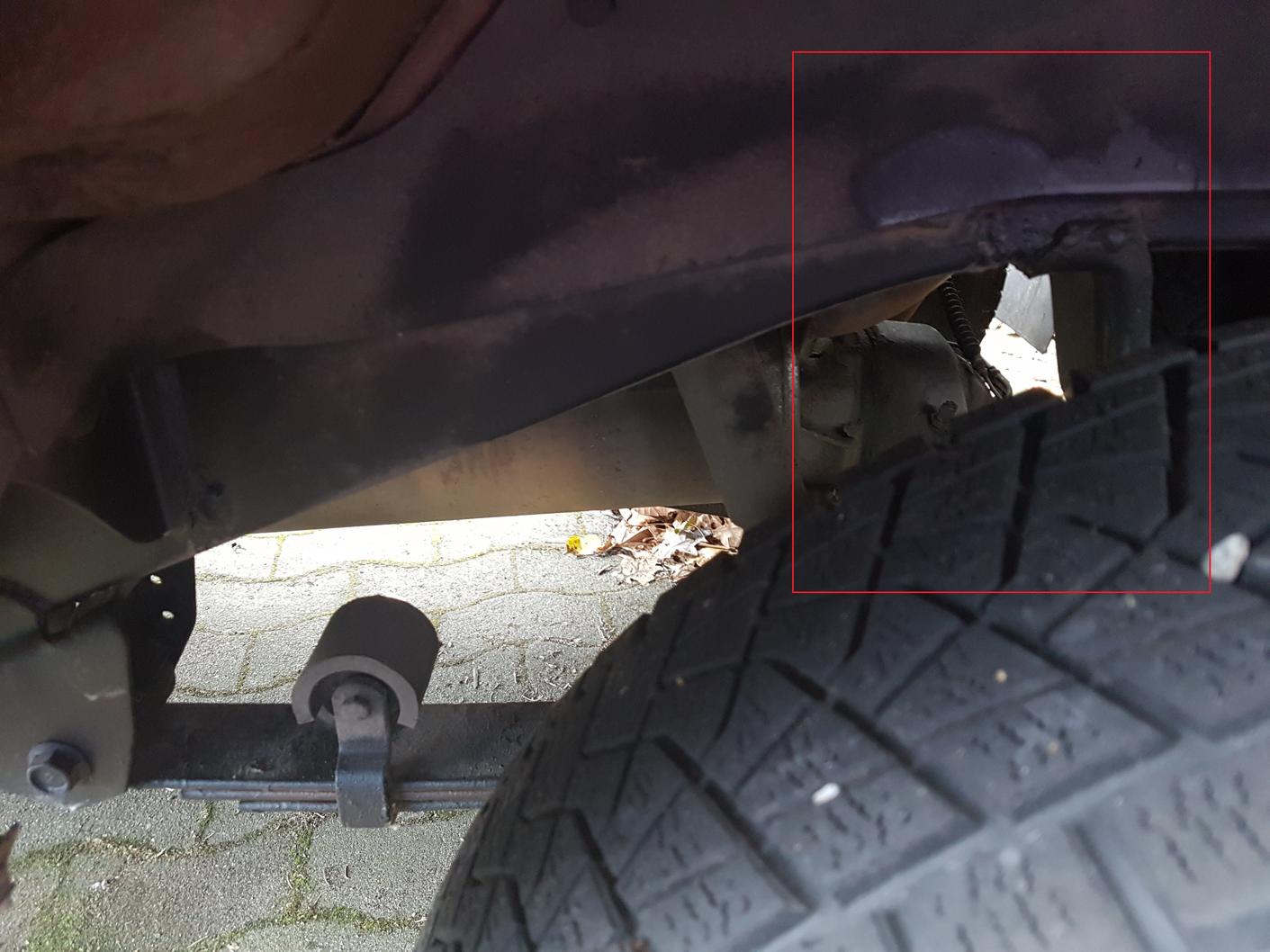

Advice please:
Look at the the red frame in the photo, it looks like a crack, I didn't see that the day I went to check the 4Runner. Can you identify the problem? Do you think it's a serious thing? Do you know which can be the reason for that crack?
