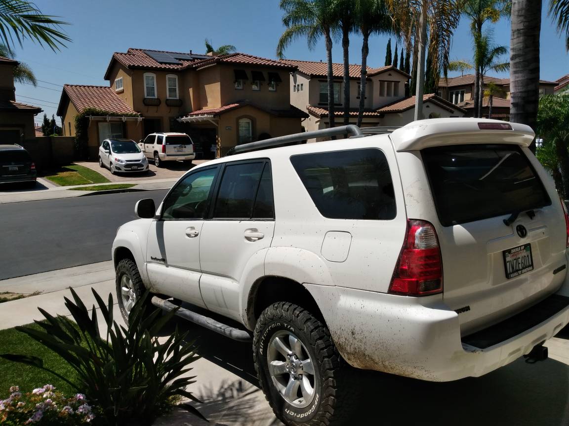

Bought a 2004 2wheel drive for my 15yo when he turns 16. I need new tires but want to go a little bigger to give it a better stance. Planning on adding the Daystar leveling kit as well but that will be after the tires. I need to know how big of a tire I can get that won't rub. It is a SR5 2 wheel drive. Thanks!
255/75r17 is another good size, and you can often find tires taken off of brand new Jeep Rubicon’s. I bought a set of 5 new BFG KMs for $500 on Craigslist.
My biggest suggestion is to get him a good set of tires. I didn't start driving until I was 18, but I know how I WOULD have been driving at 16. It's 2wd so he'll be staying out of the rocks, so I'd suggest Duratracs. Great all around in snow, ice, rain, dirt, gravel, mud (mud with 4wd, I wouldn't try in 2wd) 255/75/17 should be a good fit on a leveling kit.

255/75-17 with Daystar! I'm running 255/70-18 with daystar and spidertrax wheel spacers. Needed to do some trimming/remove front mud flaps (because of spidertrax) but it looks awesome :)

But would go with the 265/70/17 or maybe 275/70/17 if you don't mind trimming the fender liner and removing mudflaps. I have the 275's with a 3/2 cornfed spacer lift.

isn't the 2wd 16inch dia?
I just upgraded to K02's with 265/75/16
they fit perfect. look great. and the car handles better with them.
SR5 can go 16" or 17" regardless of 2wd or 4wd. Sport and limited are both 17" only I believe. Comes down to caliper size.
