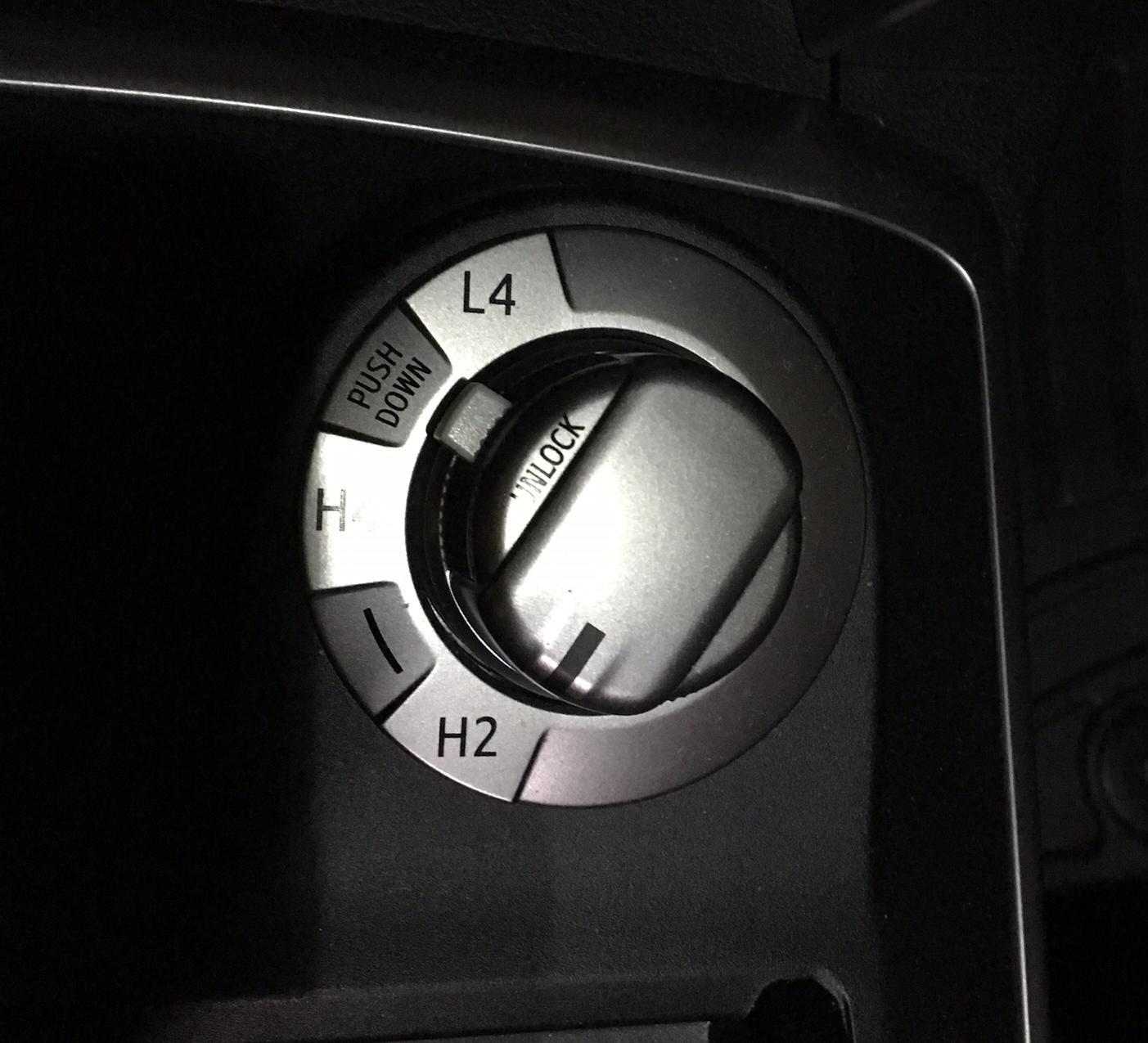

Ok, don't take offence at this question. Sometimes it is the simple things that confound us.
Did you have the grey button depressed and push the knob down when in neutral and trying to go from H4 to L4?
If so, bring it in.....

No offense taken. I think you are right, I wasn't pressing down. I wonder if the service message is just coincidental to MY failure. I'll check it out tomorrow.
