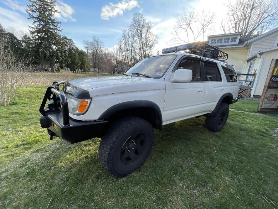

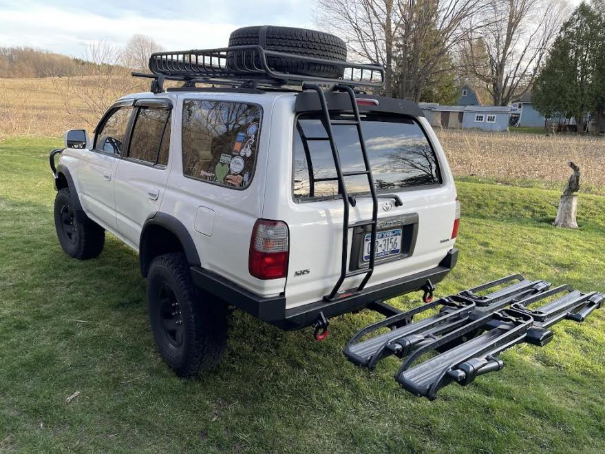

And, PICS!

Shop got my tires off, the beads look super clean, hopefully Mavis will be okay with how they look, my return credit hinges on them not being torn up by installation.
Now, to figure out what's the best option in the size I need to stick with!
265/75/16 Cooper Discoverers going on, Sunday. Happily, the tire place was willing to trade these out for what I needed, so kudos to Mavis Tire, despite being huge and corporate, they dealt with this seamlessly, professionally, and with a degree of personal touch I'm unaccustomed to in these scenarios, so they've earned my respect.
