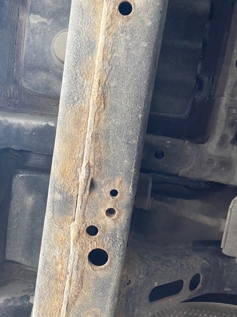

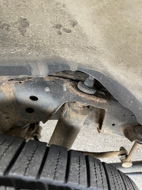

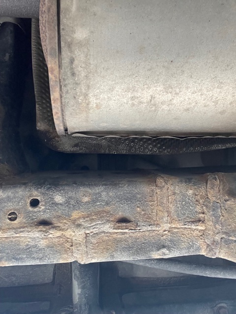

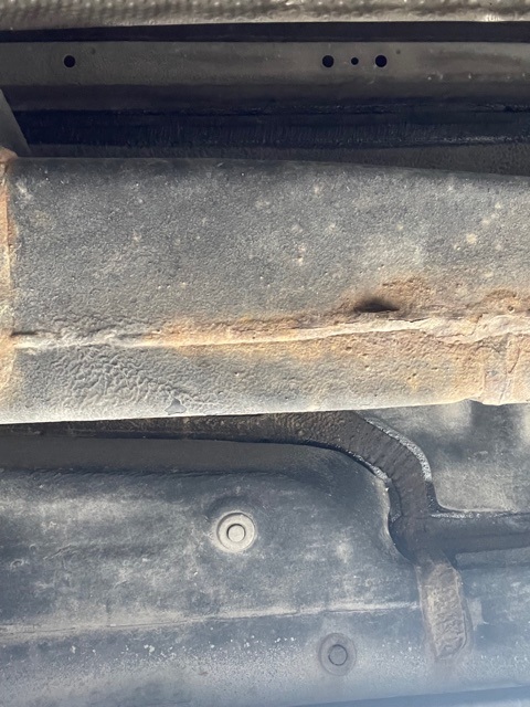

Hi there, I have a similar question and thought that it might help others as well compare the rust severity. Can you guys share your thoughts on the severity of the following pictures? I'm driving 4 hours to check it out and wanted input from people who have more experience with this rust thing.

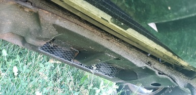

Sooooo I've moved on to another one. However this one doesn't have much rust but it did have some sludge out something on the cross member. I attached a photo. What do you guys think? Is this normal to catch road oils here? I attached a photo below
