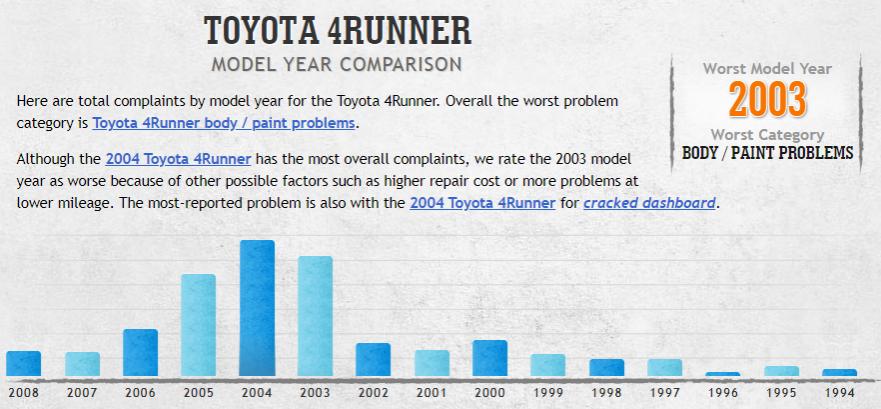

Here's a screenshot of data I pulled over at carcomplaints. It is, ofc, self-reported, but you can see that there is a big jump in the number of reported issues between 3rd vs 4th gen. If you go to the site you can see more specific details of the reported problems.
