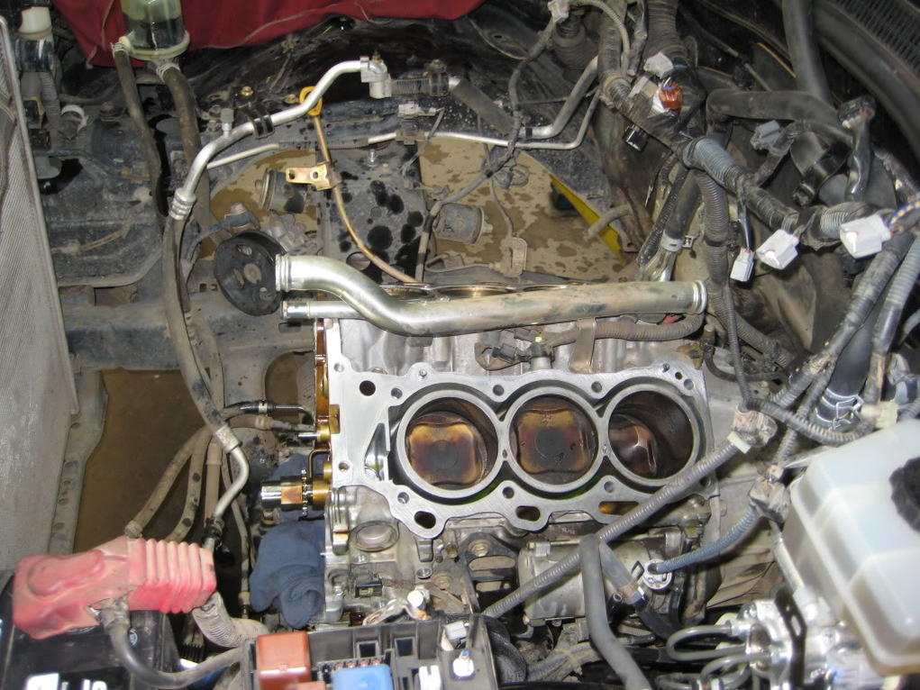

I am in search of another toyota 4x4. After considering many aspects I planned to acquire a 4th gen V6 4x4. Found a 4th gen today with a blown head gasket. Then started digging into more information about 4th gen HG problems. Guess what.... there are tons of them, which I never seen on a 3rd gen. Many 4th gen owners comment about the quality of 3rd gen 5vzfe over the 1GRFE engines found in 4th gen.
I am not an engineer, but if you look at the cylinder block of 5vzfe (2nd picture: thanks to T4R.org) and 1GRFE (1st picture: thanks to toyota120.com), you can see 1GRFE got water all around the cylinder bore at the head gasket, and with a slight misalignment a disaster!
Time to look for a 3rd gen! I love my 5VZFE!

Pretty sure the 96 5vzfe had HG issues...
Only a few were affected. This wasn't a major recall and they all got fixed. I don't see 96 5VZ's with head gasket issues any more than the other model years at this point.
Head gaskets have definitely not been a non issue for either generation. I have seen a fair amount of people on this forum alone have problems with their head gasket on the 5vzfe.
It seems like every engine comes with its qualms. You would really hope that your engine's qualm is something that doesn't render it useless until repaired. I sure wish they would have used the 1UZ when they were making our 3rd gens. Anyway.

You realize that many of the problems you are finding are on a forum, which a majority of those people join to receive help for said problems. These people only represent a small percentage of 4th gens on the road, most of which see no problems. With that said, in 06 they redesigned the head gasket.
Good news
just so you know [MENTION=85046]nissanh[/MENTION], that issue was corrected for the 2006+ model for the 4th gen.
I want a newer model and not another 3rd gen. Seriously thought of finding a 3rd gen and now, you changed my mind! Thank you. Will start looking for 06+ models. time to gather more $$$. Is this applies to tacomas too?
I'm pretty sure the more prone ones were the 03-05's. I was looking at a 4th Gen, and remember only wanting ones that were an 06 or newer. The 06 and up aren't supposed to be nearly as bad, and they have better headlights.
A little more on the head gaskets. I did some research, and it seemed to me that the issues came from people who didn't take care of them. They didn't do any PM's on the 4runner.

The design difference the OP points out is because the 5VZ is a cast iron block while the 1GR is an aluminum block. The pistons still need a cast iron sleeve to run in -- that's what you're seeing completely surrounded by the water jacket.
