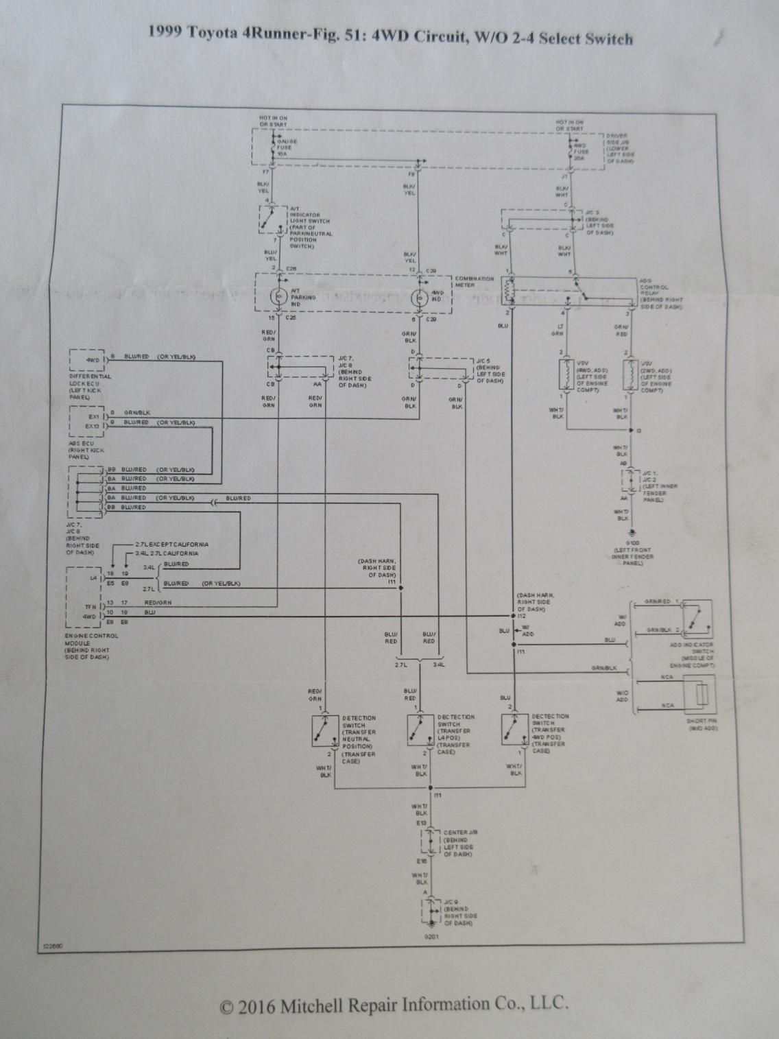

Could be transfer switch or its wiring. Here's a diagram to show circuit so you can trace it. You can get to switches easily.

That's the diagram for the j-shift (SR5/base) 4WD system. The Limited multi-mode case is more complicated (has a computer, etc.). It is conceivable that the computer is going bad, though I haven't heard that happening before.
-Charlie
-Charlie
Whoops, my bad. Yeah I only have the J shift diagram in my files.
