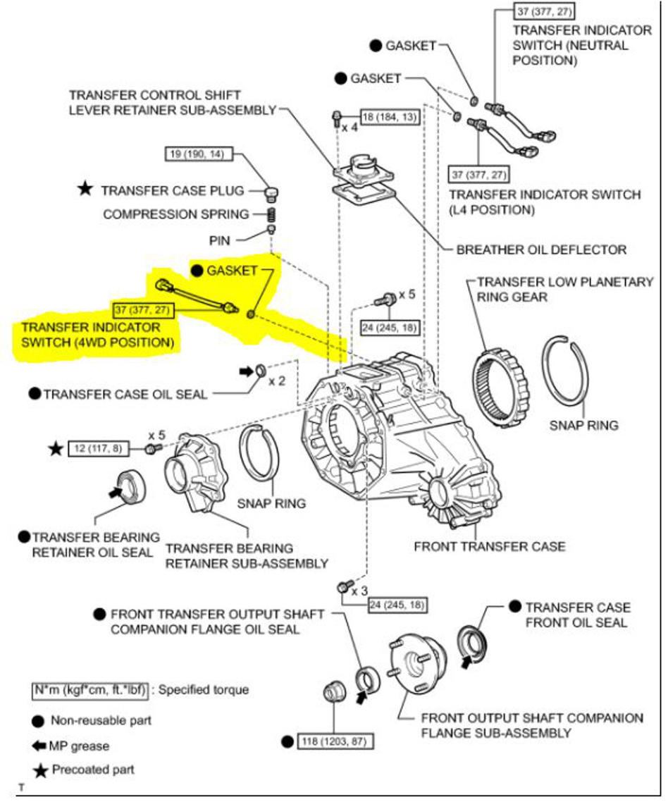

If the light does not come on and you have a manual t-case... It is the 4wd switch at the top of the transfer case. I would not normally think going in to reverse would help that, but it must be loose or something.. the twist of of the t-case reversing must be making the connection.
It can be replaced without removing the T-case, people here have done it.. but it is not super easy to reach up in there. It has to be done by feel.
The turning back and fourth.. can help with the ADD, but not that switch. The switch is what tells the ECU to engage the ADD.... There is also a 4Lo switch, so make sure you change out the 4H one.
I think this is the best place to start IMHO. If you are not getting a light, then the vehicle is not sensing your intentions to engage 4wd. If it realizes you want 4wd and it can't engage for some reason, the light will come on and flash. This has happened to me a bunch, but I have never had a no light situation.
This is the switch... on the passenger side somewhere near that center rib. Should be pretty easy to feel. Might just try messing with the connector to see if that resolves it.
Thanks [MENTION=106176]wfo9[/MENTION] and others this is awesome info. Ill try replacing the switch and see where I get. Will report back just in case someone else runs into the same issue.
