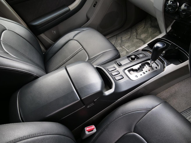

I'm pleased as I currently have a fulltime 4WD 2007 Suzuki Grand Vitara (I don't think you have them across the pond) and love the sure-footedness of it.
After years of full time 4WD and no power (Only a 2.0 4 pot!) I was a bit worried about a 2WD 4.0 as this doesn't have any form of traction control. Glad I can put in 4WD in bad weather on the road.
What makes you think you don't have traction control? Every 4th gen in the US does.

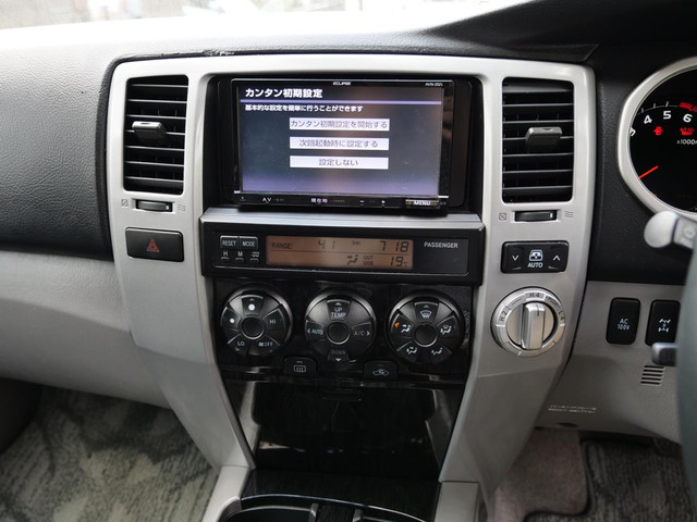

It's a Japanese import to the UK. It squealed the rear tyres easily enough when I took it out and gave it a prod :lookout:
(On private land of course, officer...)
There's no over-ride button either which most cars I've seen with it have usually...I could be wrong, I haven't driven it properly yet
I'm not up on my differences between JDM and USDM models, but I'd still be very surprised if you don't have traction control. Over here, a TRAC OFF function was added for the 08-09 models only. Everything prior doesn't have it, so that could account for your 07 not having anything.
Play around a bit more, get it on some grass or gravel and try to do a burn out or donut. If traction control kicks in, you'll get a flashing dash light that looks like a car with skid marks, and you'll get lots of clicking noises from the engine bay as the brakes are modulated by the system.
Like the other poster said, you won't have a button that says anything about VSC or TRAC on that model year. Check your manual and dashboard, if you have a TRAC OFF light, you have the ATRAC system, and if you have a VSC OFF light, you have the stability control system. I would be willing to bet your runner has both just like every other I've seen. To test the difference, you can disable those two systems as well as the ABS by disconnecting the brake master cylinder sensor in the engine bay.
I'd be very surprised if you have a 4th gen 4runner that came without those systems!
