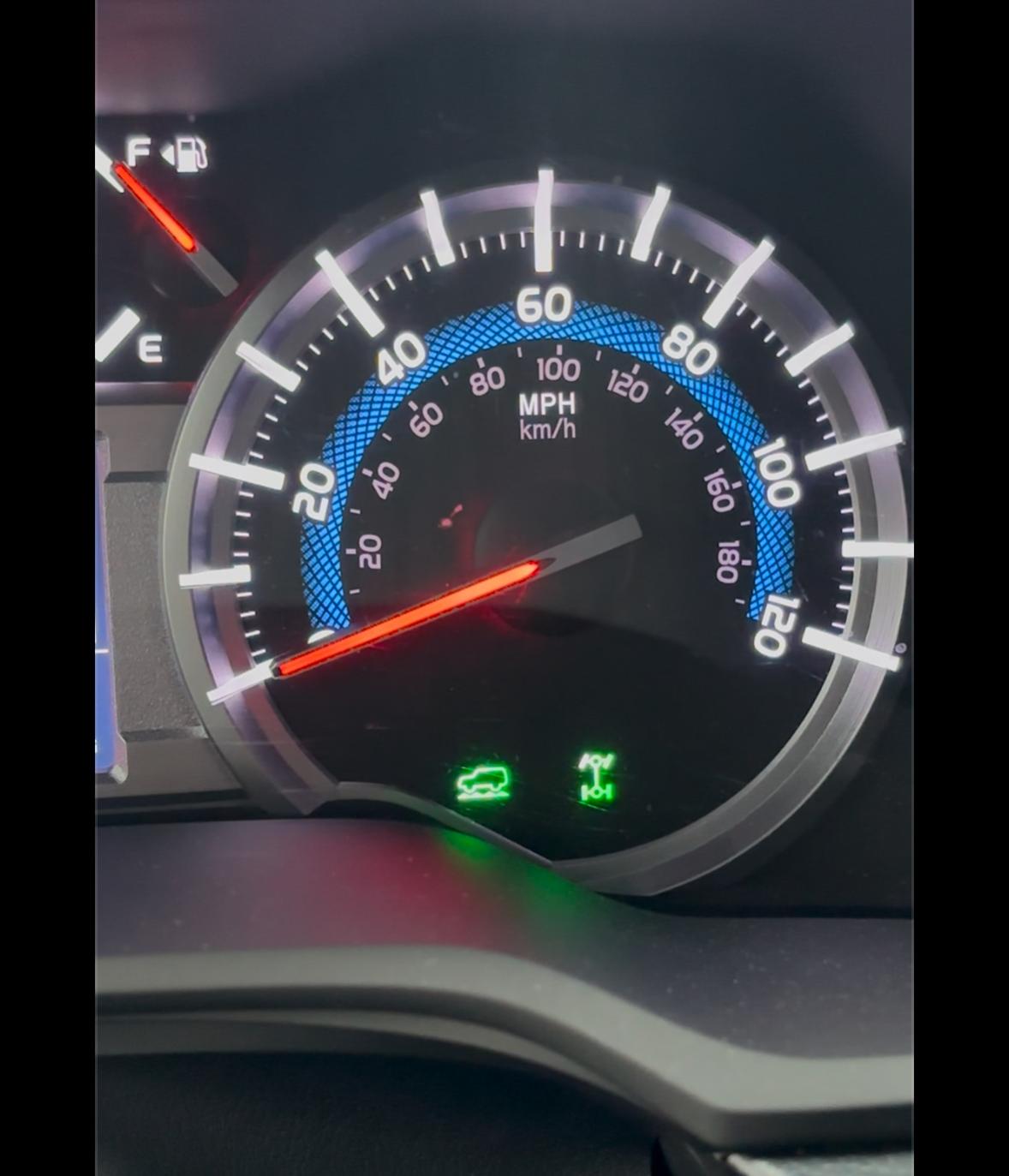

4wd will not engage and I’m getting these dash lights intermittently flashing. Any indication what this could be? A sensor?
2014 Trail with 170k miles

The owners manual says you must activate the 4x4 system often to keep it functional. If you don't, it may freeze up.
Drive forward slowly and turn the steering wheel a little. Mine is slow to engage at times after not being used for a while.
After it engages, shift it in and out a few times.
I use mine at the boat ramp just to keep it working.
My dad has a 2002 Chevy silverado Z71 with 31,000 miles and have never used the 4X4 system.
It has just started throwing the code of service 4X4 ..
The dealership told him its from never using it . I use mine all the time just for that same reason.
