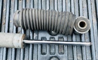

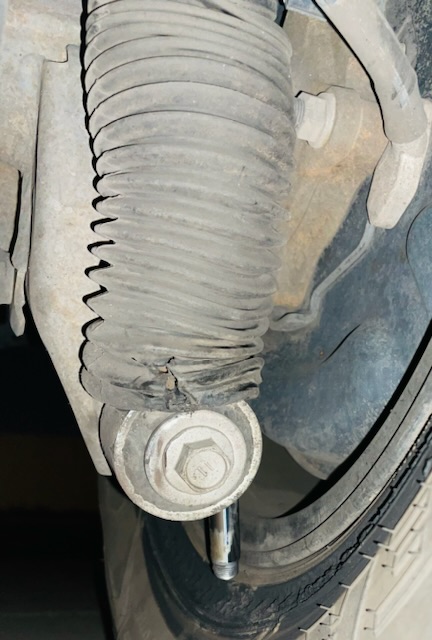

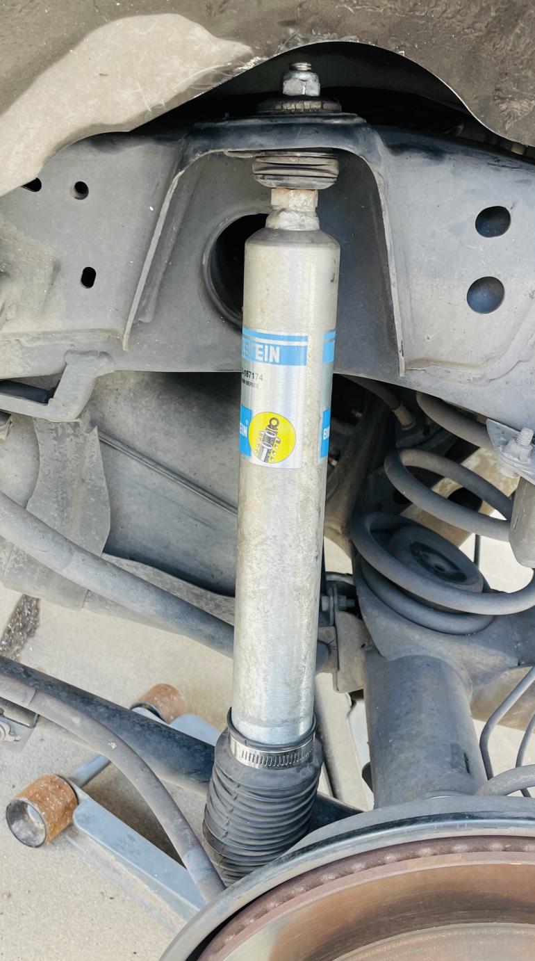

Bilstein 5100 rear Shock slightly broke today. Street driving and Snap...damn speed humps.

Looks like the shaft unscrewed from the mount. Not the first one that has been reported…..and concerns me since mine were just installed recently.
Hopefully yours gets replaced quickly and under warranty.
Looks broke to me. This happened to a buddy of mine last summer. Unfortunately they did not warranty his cause they said it broke outside of the 30 day warranty.

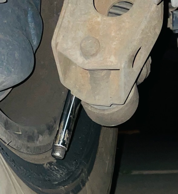

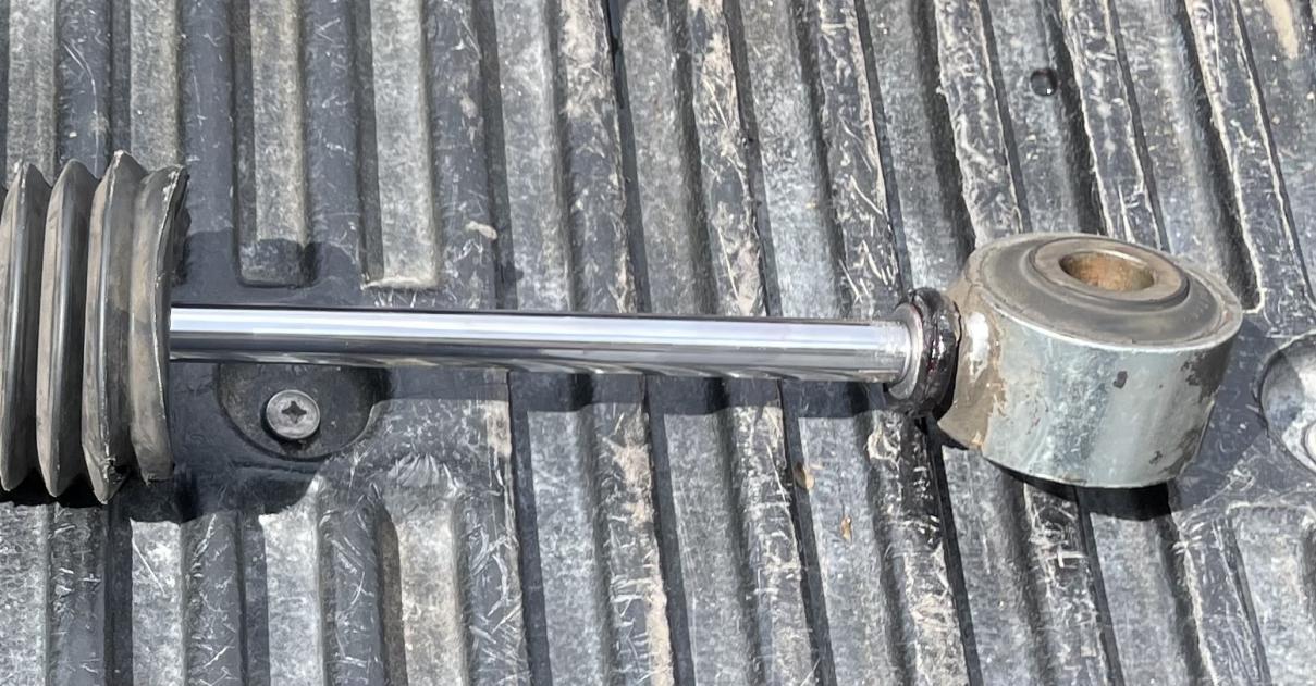

Shock is Off. It threads right back on the lower shock mount. It just unthreaded itself.

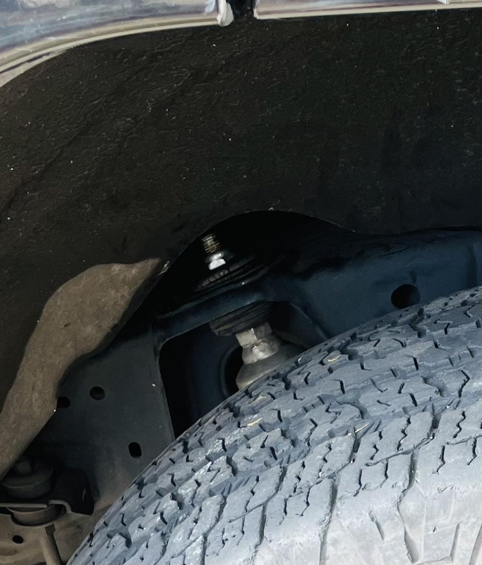

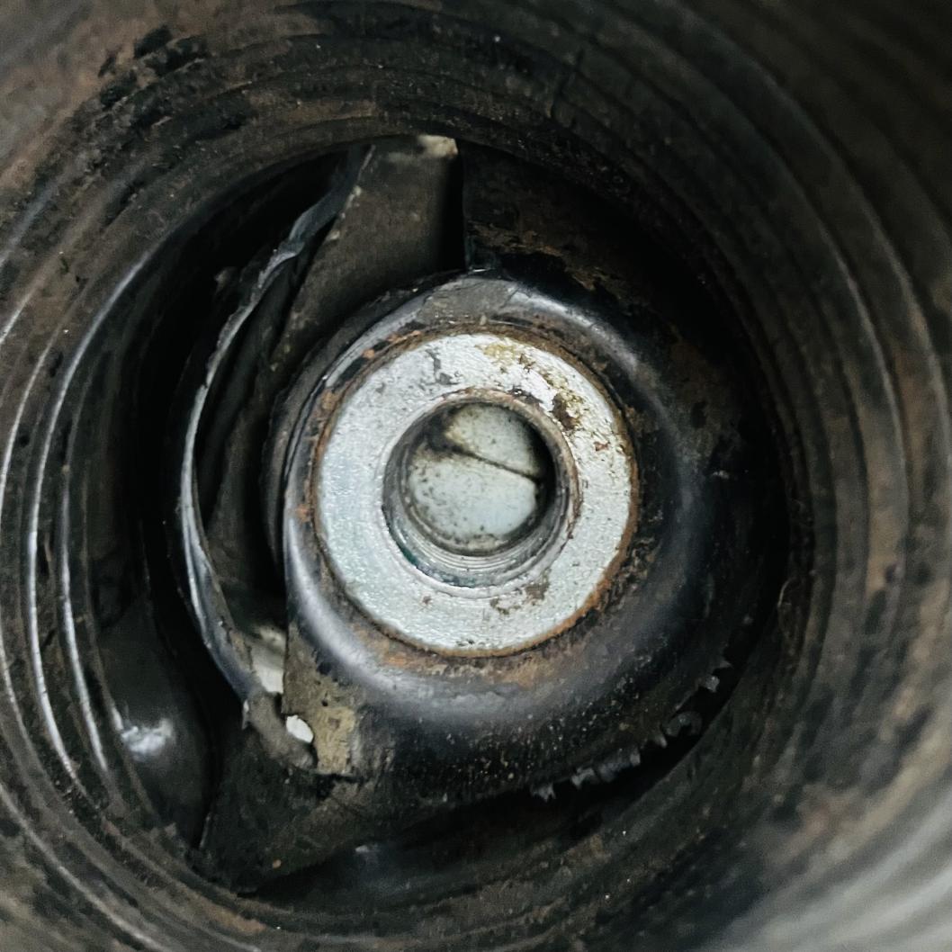

Done
