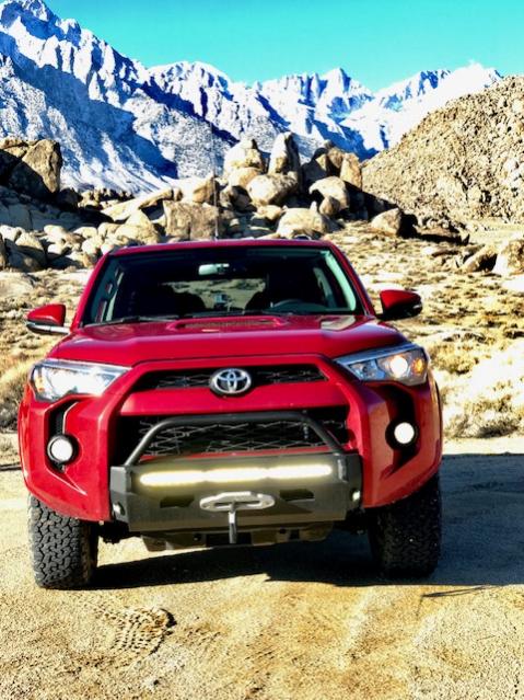

I'm really happy with the Southern Style Lo-Pro / Smitty Bilt X20 / Baja light bar combo. I know C4's are great too, but thought you might want to see if this option might work for you.
They don't even make one for the 10-13 4runner though, so how does your post even apply to this thread?

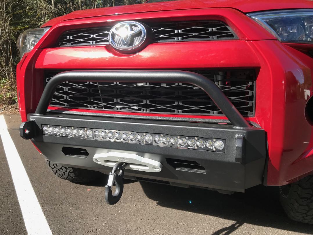

Does anyone know/have pictures of where the light bars will go or what the bumper will look like with/without the led cutout?
Confused by your question. What exactly do you want to know? Theres only one bumper at the moment and its in the pictures on the previous page without a light bar in the cut out. The bumper in those pictures has a 20" cut out with no light bar installed.
Yeah ended up going through the pictures and figured it had the 20inch cutout with the C4 stamp on it. I went ahead and ordered it. Wondering how strong those recovery points are though?
Those recovery points are 100x stronger than any stock recovery point on the vehicle. They are very solid and I wouldn't hesitate to use them.

Question - Will the trim piece to go around the cut area be included or should I go buy myself?
Is there a professional testing committee that I havent heard of? Or are you saying people just going out and using the shackle mount?
You made a performance claim and I just asked if it was tested. If the number was just made up then easy enough to just say that.
I made the claim based on a number of things.
1. Roughly, a36 steel is rated at 36000 psi. So that 3/4" shackle point has a cross section over an inch and will pull about 40k lbs. The bolts are rated at over 50000 psi. The sheet metal frame will rip out before the bumper will fail.
2. C4 has sold thousands of bumpers. If only a tiny percentage has used their shackle point, even if one failed, the whole entire internet would know.
3. This is good steel with quality welds.
All I did was ask if there was any testing done.
