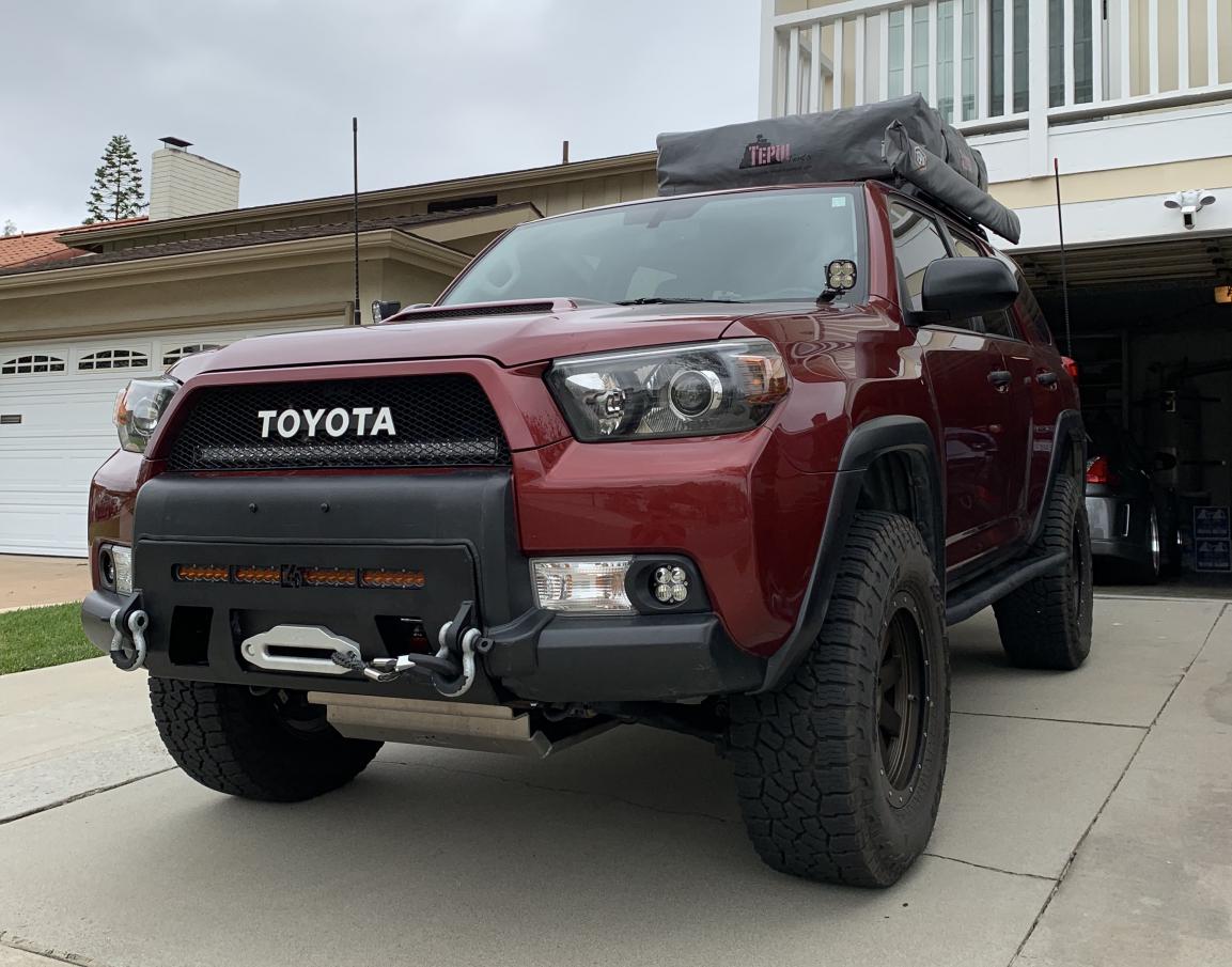

Installed the c4 bumper today. Still missing some things.
Looks awesome. Where in Denver are you? Surprised I havent seen another nicely built 2010 TE.
Random question but are those Methods and do you have wheel spacers?
Got so close last night... today will be the final cuts on the bumper and I'll post a finish shot

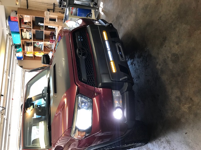

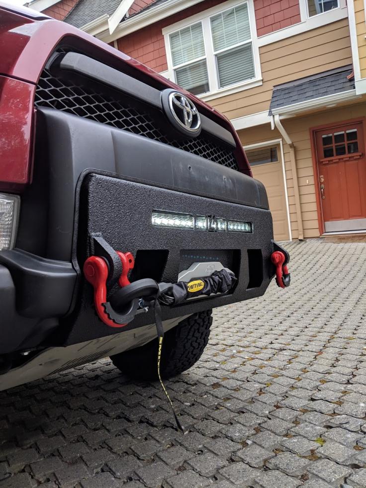

Finished up today. I want to thank you all for the inspiration to tackle projects like this. I've used the forum heavily in the last few months to dial in my rig and couldn't be happier with the results.
I used Raptor Coat with the UPOL Acid 8 etching primer for the finish on this bumper. I thought it was super easy to work with and provided the finish i was looking for.
Rigid SR Pro 20" Midnight Edition lightbar, and smittybuilt x20 synthetic winch finish out the build

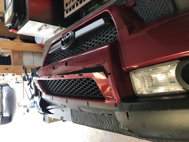

Can those that have done install, can you confirm that that the trim-lok edge trim is:
1/16” edge
25 feet
3/8” leg length, single
(Just want to make sure amazon link transferred correct selections)
Thanks!!

This is the one I went with, 15’ length. It has a small metal lining and it helped bending around the corners. Couldn’t be happier with going this route and it has the same look as what C4 used.
Edge Trims Black Small 0.375" U... https://www.amazon.com/dp/B00N9VGDBM?ref=ppx_pop_mob_ap_share
^yap I ordered the same ones using Ryan's suggestion. I'm on the fence on trimming all the way under and around the drl/turn signals to the fenders. There are a few old threads I'm reviewing for visual ideas.
Thank you yeah that took some planning, I had a muffler shop cut the trail gear hoop ends flat and weld it on. The welds weren't as clean as the tig welds but the PC shop did a great job of prepping. I wasn't sure how high up the bumper I had to cut but made the best measurements I could. The lower bumper trimming was kinda last minute, it's still growing on me.
Those are just stock TE headlamps, they have the black trim inside, my LS460 projectors are a work in progress on the dining room table, I'm using my original set for the implants.
