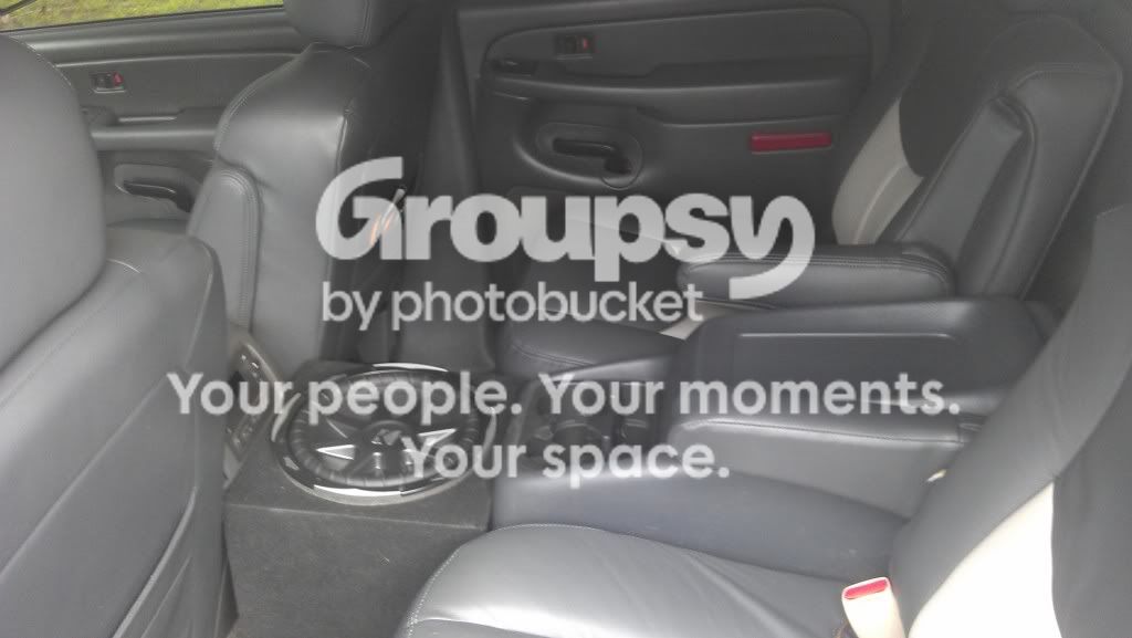

So we have a 2012 LE with 3rd row seats. They primarily stay folded down and we use the cargo area. Recently the misses went and looked at platinum Sequoias and loves the bucket 2nd row seats, similar to what most Yukon and Tahoes and Suburbans have. It does give the 2nd row passengers more comfort in a bucket seat as well as make the entry into the 3rd row more accessible without folding down seats and squeezing in the back. We rarely use the 3rd row because its such a hassle to get passengers back there since our child is in a car seat in the 2nd row. so in order to fold the seat down and access the 3rd row you need to pull the strapped in car seat out first. MAJOR hassle and makes using the 3rd row pretty much useless. Has anyone on here done a 2nd row bucket seat swap. I am very mechanically inclined and can build any bracket and machine any pieces necessary and have done many bucket seat swaps in regular cab trucks in the past. I know the floor has a rise or two under the 2nd row seats but the carpet is solid under the seats so doing bucket 2nd row the floor will look somewhat normal. i may even built a small console that can be slid forward or something that sits between the two seats. Looking at seats on ebay, and then corresponding videos on youtube on seat functions, i think the Honda Odyssey seat is probably the most legit. the seat will flip forward and fold up into the floorboard for great access to the rear 3rd row seats. you can leave the center seat in, leave it folded down for a console, or run without it completely. But our car seat could sit on the passengers side, and the drivers side rear be the one that folds down in order to allow passengers into the back seat. since the seat will simply slide forward, and also fold in half and flip forward, i think this is honestly a great candidate for a conversion. The seat base needs to have two loops in the front of the seat for the latches to catch onto and a bar at the back of the seat to latch to as well. the seat slides forward and backward within its own track built into the seat base.
i really liked the idea of the toyota sienna, the color matches our T4R seats plus fit and finish would match but the sienna seats slide forward and back with a track in the floor. that would be a no-go on our stepped floor. even with the stepped floor the Honda Odyssey seats may seem like a difficult swap but there appears to be a substantial amount of room under the seat to the latches, i bet i could cut a solid 2" out of that room to make the front and rear latch work on our stepped floor. Here are some pictures and a short video of the Odyssey seat and its functions. The Odyssey seat appeals to me because the center seat can be latched in for a full width bench or folded forward for a tall center console, or pulled out to reveal cup holders in the floor. There are so many possibilities.

Here is another one i found with an actual real center console with flip up lid. i am sure some massaging and you can make the plastic center console follow the contours of the stepped floor we have. and since the two buckets will flip up and out of the way to gain access to the 3rd row then you should have plenty of room and comfort.
bad thing is this set is grey and we need the light tan.
CHARCOAL LEATHER COMPLETE SET 2 BUCKET SEATS & CENTER CONSOLE truck hotrod van | eBay
