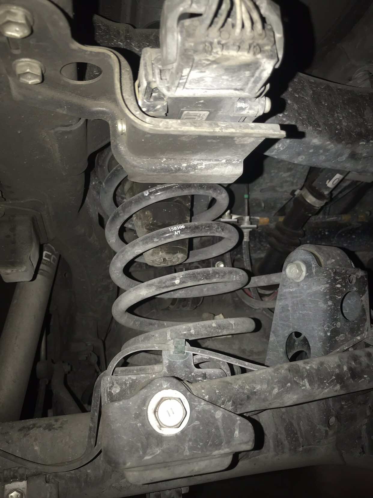

I bought a 4runner that already had an icon lift all the way around installed.. I’m noticing the lean that I’ve read all over about.. The question I have and notice from the picture is the bumpstop isn’t directly in the middle of the coil.. Could the coils be installed on the incorrect side or does it matter?? Any ideas on how I can fix this or a spacer my only option?? Thanks IMG_1040.jpg

Which one did you go with?? I don’t see a 1” or 1.5” from OME
Yeah I did the 10mm. Still has a little difference but not much and only noticeable by measuring. I don’t know that mine was that extreme, but I would have to think fuel level may play into the measurement some on that side??
