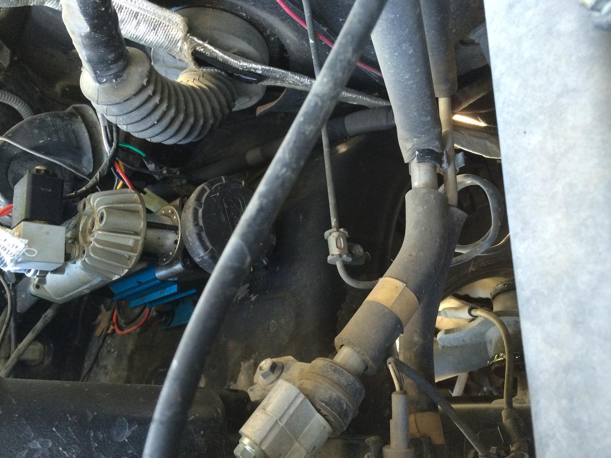

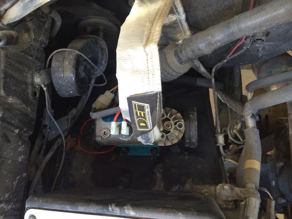

Also, are you running the ARB compressor? I have the CKMA12. If you have that one, how did you mount it? I need to get a mounting plate from somewhere.
On my FJ I had room just behind the TRD air box on passenger side. The foot of the little CKSA12 kit can be re clocked so it was direct mounted where you see it in my photo... Yes dirty and used hard.
I have room in three places in my engine compartment. I just think I need to fab a bracket of some sorts.
