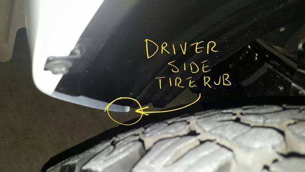

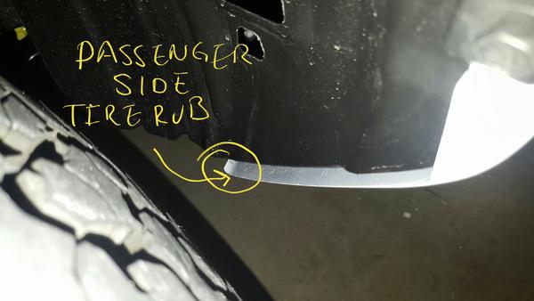

Here's fresh pic, without the running boards, and pics where it's rubbing. Surprisingly, it's not rubbing on the inner fender well. I'm also going to put a heat gun to the front mud guards because it just barely rubs
I'm still at stock height, but when my 5100's come in, I only planned on setting the fronts at .85 in front because I just wanted to give a slight lift to lessen the rake. Putting Bilstien's in the rear, but planned on keeping the stock springs and no spacer. If the lift won't help with the rubbing, then I guess I'll break out the dremel and slice a little off... thoughts?
Maybe go up a notch on the front and some 1" cornfed spacers in the rear?

The Pro's rub in the part and there is a TSB from Toyota and temples on trimming the bottom of the front bumper. You will be able to find it on here, good luck! It looks good and I like your lift plans.
Thanks! I found the PDF for T-SB-0009-15, but looks like a lot of work. Since the rubbing is really towards the innermost side of the bumper, I think I'll do something like this : post2123831
