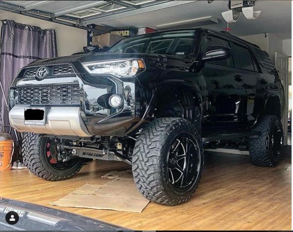

5th Gen w/KDSS +3" Lift
Dillusion
Not mine saw it on IG. I asked for more details see if they give it out.

that looks like a 6 inch bracket lift.
Love the look of them, but glad I don't own one.
It is a 6" Pro Comp but I was always told no go with KDSS. I messaged um to see if they willing to give out some info.

As for the lift, they don't even show full kit for the 5th gen, just a spacer lift, but they claim it only goes to the '12 model year even though the suspension is the exact same.
That looks like an SR5 with a silver valance. If it was a Trail/TRD Off-road with KDSS it would have the turn signal blinker on the side mirrors unless they blacked it out.

Its a TRD Off Road with KDSS. Look at the sway bar in front of the bracket lift, thats a kdss bar and hydraulic system.
The TRD Off Road does not have the mirror blinkers, only the TRD Off Road Premium. It's how you can tell a regular TRD OR from a TRD ORP.
definitely a DB lift done on that big boy. We can definitely do full 3 inch lifts here for kdss but definitely dont cut into the cross member
Lift done by 4 Wheel Parts here in Waipahu. If I have time I'll give um a call and see what they did to get it to work with KDSS.
Well I am no engineer, the solution seems pretty simple, fab a bracket to drop the KDSS piston and passenger side linkage. Without modification I would guess that piston is really close to bottoming out. *only an observation, so as to not be ridiculed by an actual engineer*
