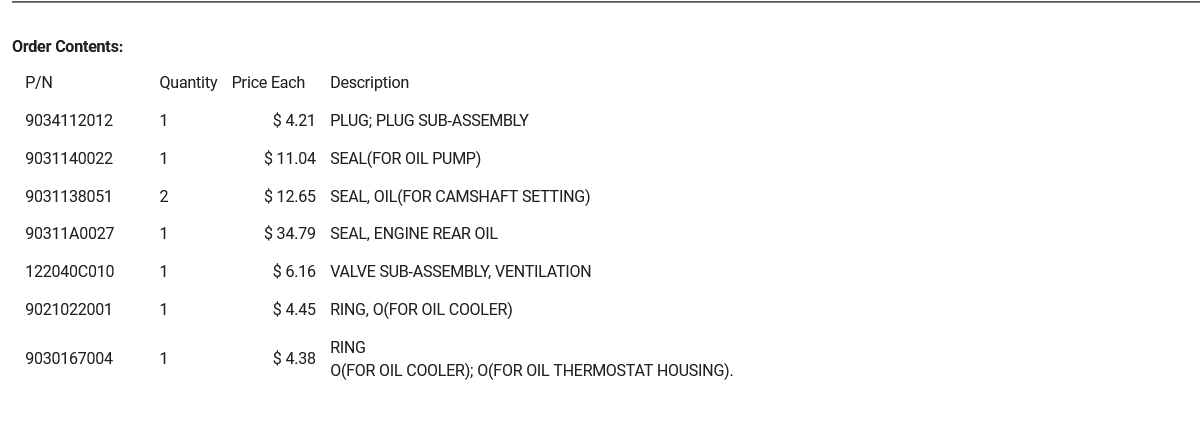

Hello, I'm finally getting around to swapping my 3rd gen and have sourced a replacement motor. It's lower miles, but while it's out I'd like to have it squeaky clean and as renewed as possible.
So far, I've purchased the following:
Gasket Set - Toyota 4Runner, T100, Tacoma, Tundra V6 3.4L, 5VZ (1995-2004) Long Block Install Gasket Set Kit-2023
Timing kit- Toyota V6 3.4L 5VZ-FE 4Runner, T100, Tacoma & Tundra Aisin OEM Timing Belt Kit with Water Pump, NO hydraulic tensioner (1995-2004) TKT-005
Plus some additional parts from a local dealer (see image)
Is there anything else I'm missing? I don't want to mess with the internals, headgasket should be fine (assuming it passes a leakdown test). I also have new LBJ's but that is not strictly engine related.
Thanks!

Looks like you've got most of it covered. I'd recommend adding an OEM thermostat and heater core water valve to the list. Maybe an IAC gasket if you haven't cleaned the IAC in a while.
EDIT: That's the wrong part number for the PCV. I only checked the PCV part number because it looked weird to me. I didn't check any other part numbers.
Might be worth rebuilding the starter and throwing new brushes in the alternator. Pretty cheap parts relatively easy to get to any time but would be really easy to get to with the engine out. Might also be worth re sealing the engine oil pan while it’s out. Last thing I can think of is rear main seal.
Yep on the starter. I rebuilt mine put it in the engine bay and within 6 months I was pulling the starter for contacts.
Spend the extra money on the high volume oil pump. This engines oil pressure at idle is way low compared to what I’m use too.
New Aisin fan clutch. You want that engine running as cool as possible. Should be p/n Aisin FCT-013
