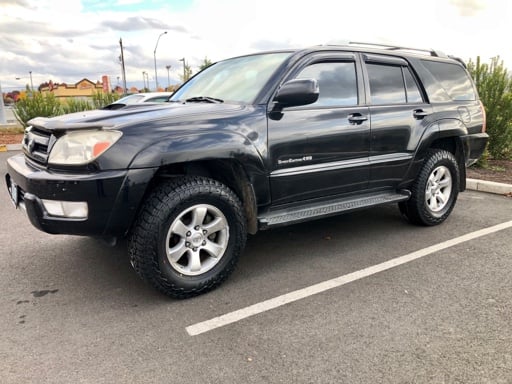

I just installed Falken Wildpeak AT3 LT265/70/17 today. Extremely happy (new car feeling). Very aggressive look. 4Runner is completely stock. I have no rubbing at full turn, X Reas Suspension still ☹️ But 300k miles and going strong.
LT version tire is 31.9". 4/32"more tread depth than P version. 138.00 per tire I could not pass it up.

I have a 2004 4Runner Sport V8 4x4
