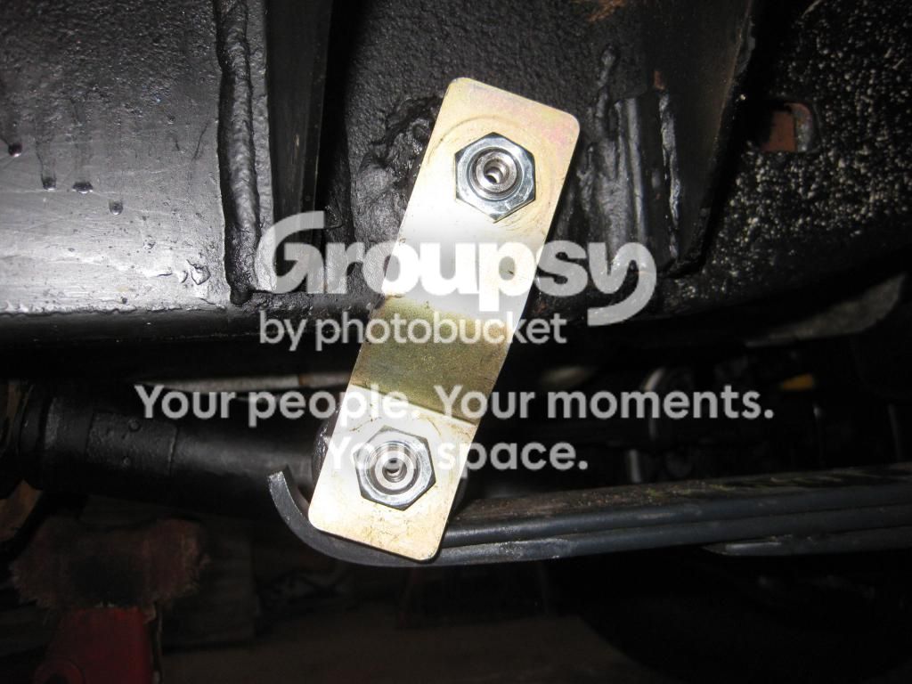

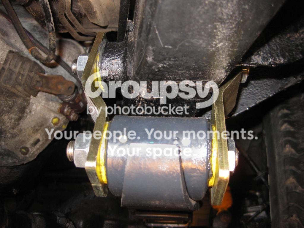

I am still working on the truck, it is not on the road yet, The only driving has been up and down my drive. However I went under the truck to work on something else, I discovered this:
I know it is not right, its shackle against frame. I tried to mimic the old toyota shackles when I did the install. I now notice that the left (inside) shackle above has a notch in it. Was that a reference point? It looks like I need to flip the shackles upside down from how I have them. Not sure why I didn't pick this up when I did the install but now I need to correct this any help/suggestions before I tear it down again? be gentle guys, my first lift install. thx Bill
Looks to me like the inside shackle has a different bend in it. I don't think you need to flip them, I think you need to swap them.
Was the old shackle doing the same thing? The one side plate has the bolts pressed into correct?

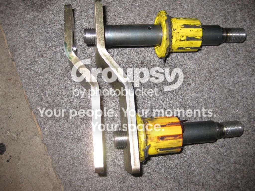

Thank you guys for your replies you gave me some options, here is what I found out. I got a chance to take the passenger side apart and put the shackle halves side by side

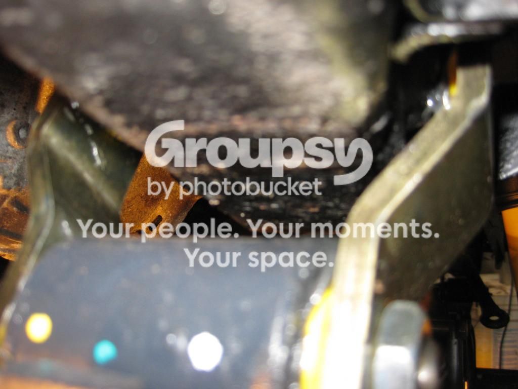

So it wasn't that, even though it seemed likely. With the OME shackles, one side is threaded and that side is designed to face the outside of the truck to allow easy greasing with the zerk fitting. What I did was to unscrew the bolts and reinstall them to the other side. The picture above shows the bolts how I first (incorrectly) had installed them. When corrected, the bolts are coming through the left side of the same shackle. I hope I explained that properly since I didn't take a picture. Here is the corrected version
Better than it was, now I have a small 3/8" clearance between the frame. From the side the shackle angle is
So that is going to be as good as it gets

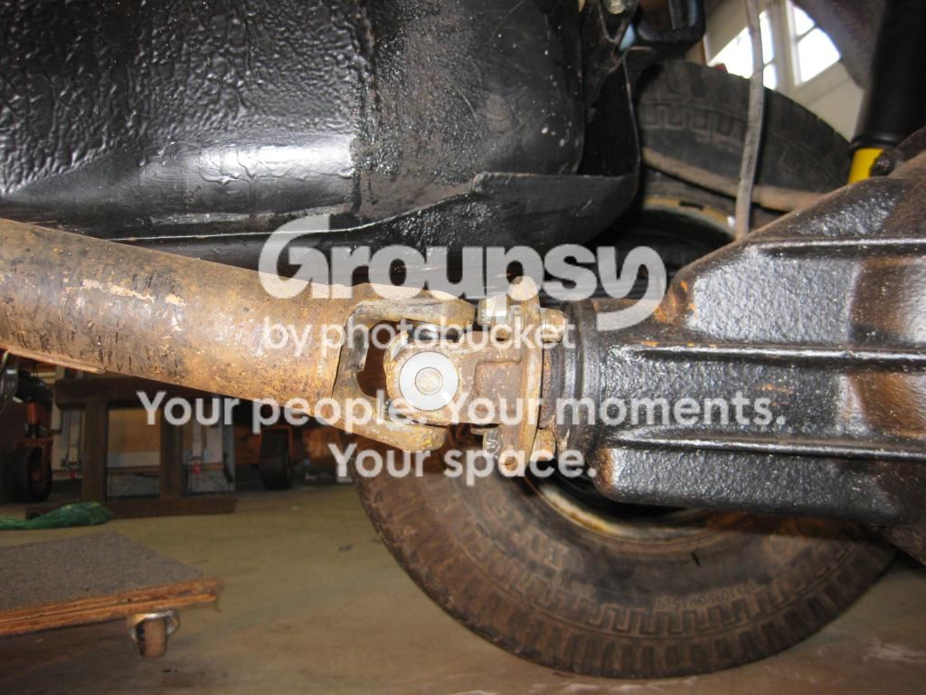

Base runner here are some pictures of the pinion/driveshaft angles. Front:

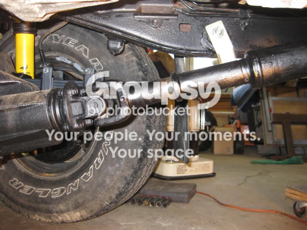

And the rear:

Front angle looks good, can't be sure about the rear without a pic of the other end. But if you don't have any vibrations it must be good.
