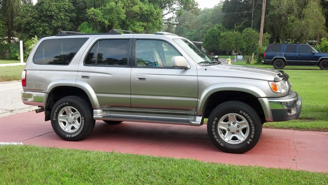

finished the suspension build today and this is how she looks. 906/billies in back. and since i didn't find any tundra coils, 5100's/stockers with perch in 4th groove. when i do get them, i will swap. i like the way it looks and handles. definite props to everyone here for their input and help.
Are your 5100s for a 4Runner or a Tundra?
How do you find the stock front springs WITH the Tundra billies on the 4th setting? Does that put a compounding/constraint on the spring and make it less flexible or something like that? (0 setting VS. 5th setting kind of thing)
i don't notice much. it rides the same to me.
