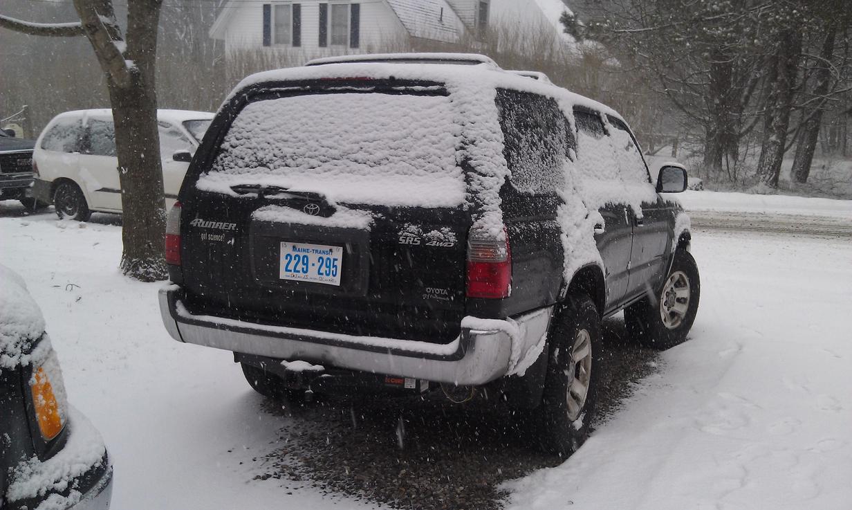

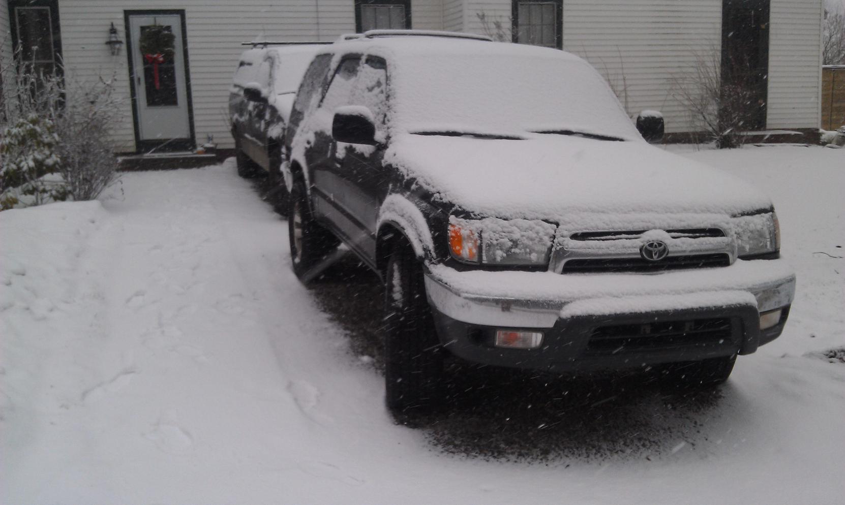

Thanks again, everyone. We are NOW the proud parents of a 2000 T4R.
