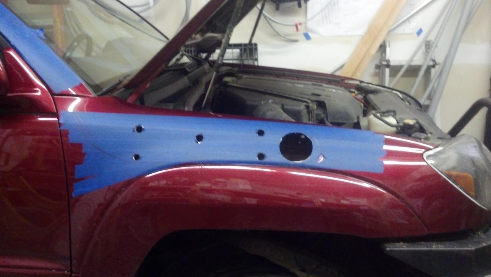

How did you decide where to poke holes. I have 4th gen snorkels in stock (parado) but no template, and I do not have the intestinal fortitude to cut a hole in my fender.

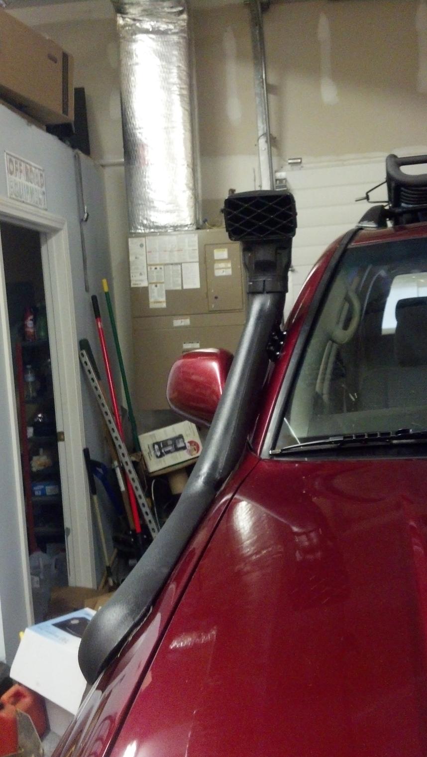

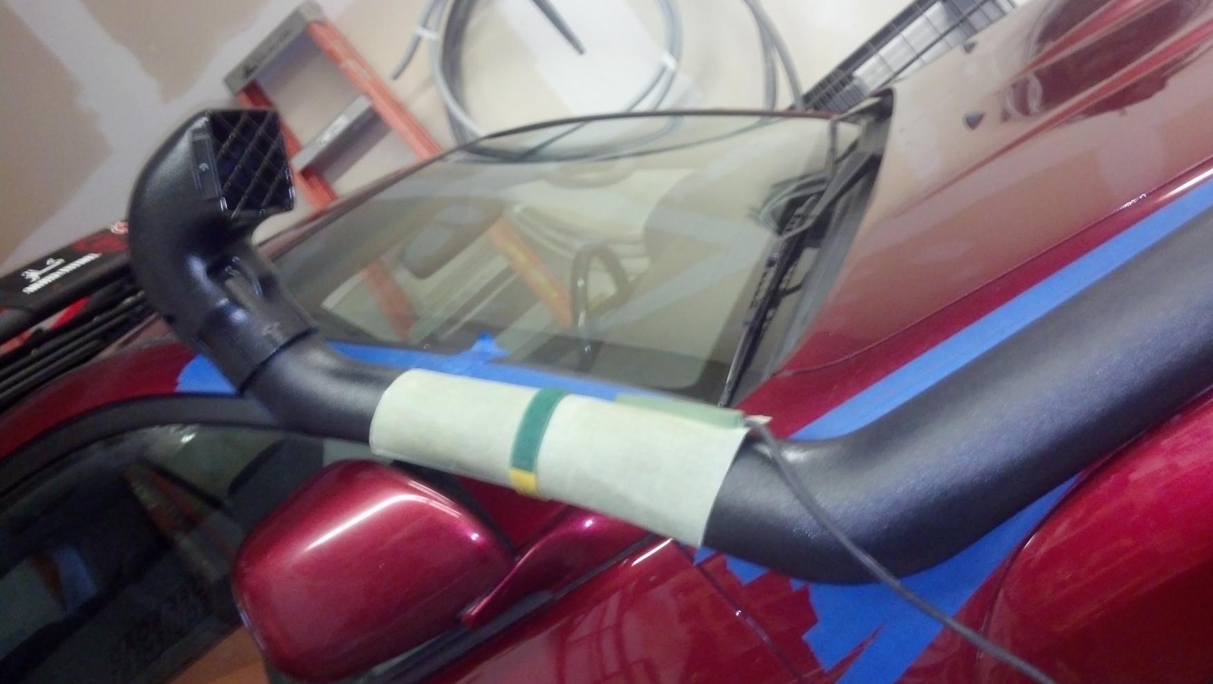

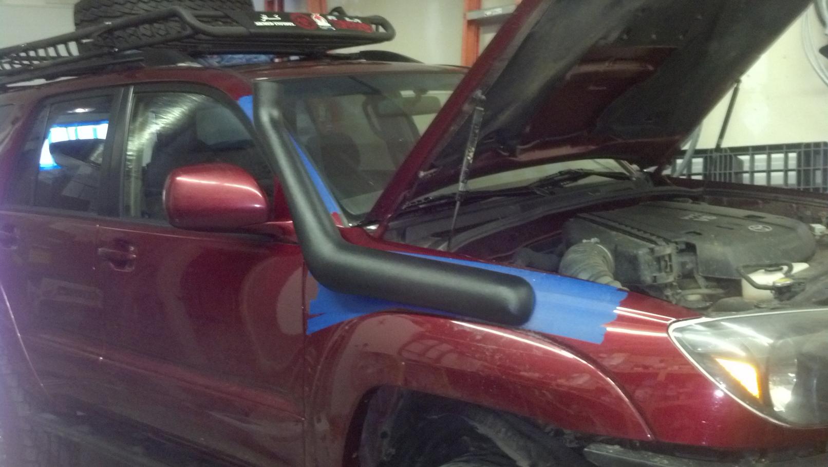

Lining up the template was a combination of eyeing up and carefull , repeated checking of positioning. I cut the main hole, inserted the through the fender part of the sbork and then heated it and bent the upright slightly. I put the studs on it and marked where they needed to go. I was very carefull and it took me about an hour to actually position it all . I drilled the stud holes larger than i needed so i would have a little bit of play to work with.

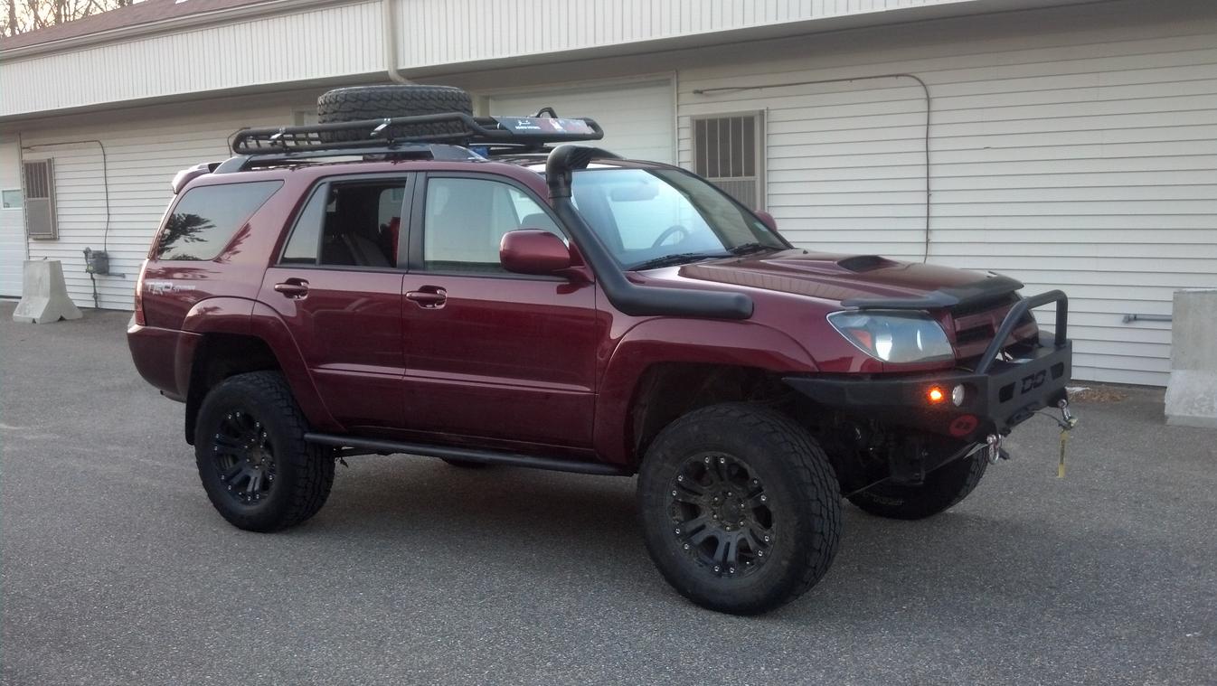

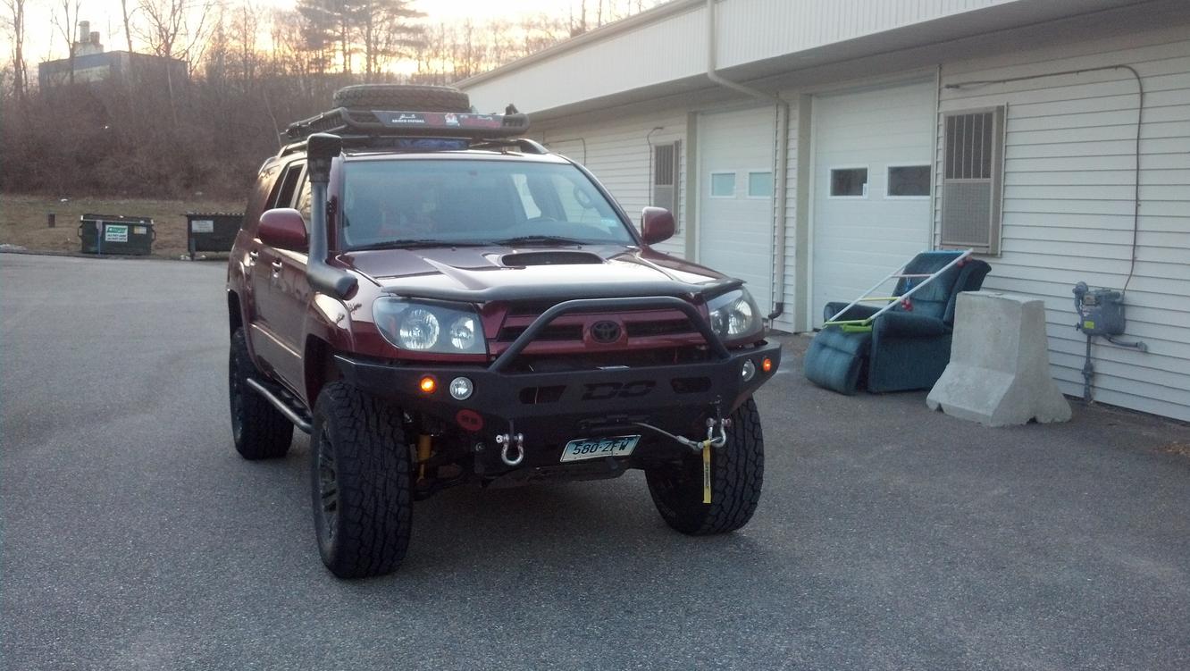

Everything has been plumbed up for a while now and is working great. Im happy with this cheap chinese snorkel. I got it on Amazon and will get you guys the part number. I havent checked in here for a little while and i apologize. Please note this installation is not easy nd you need to be committed and capable to make it work !
