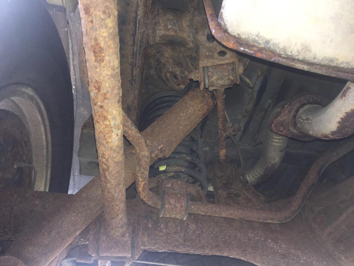

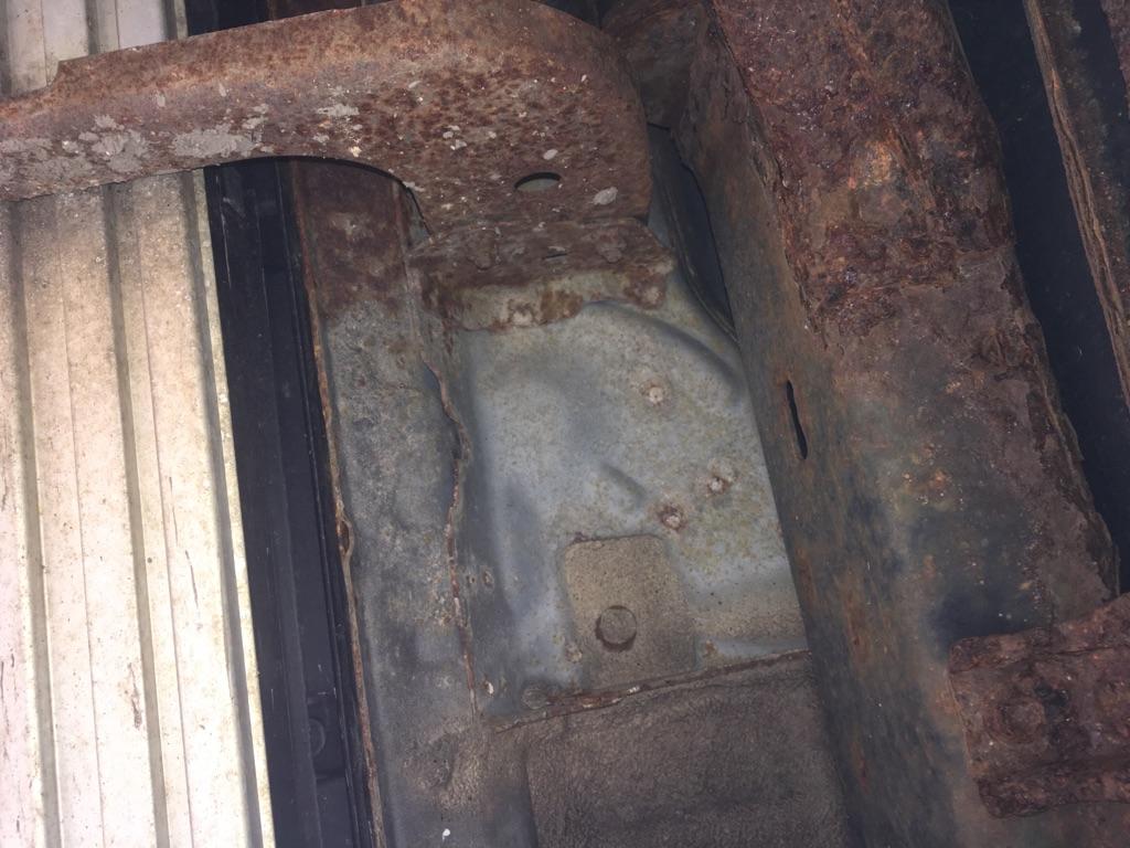

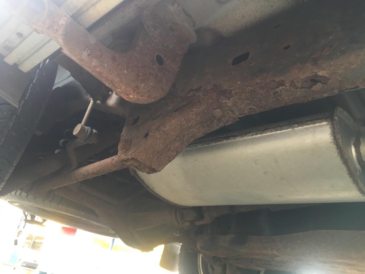

Post pics of the entire undercarriage. You might have gotten a rust bucket from up North.
The frame is not great but I'm hoping its salvageable. But you can see it flaking off in one of the photos.
This one came from St. Louis area. I think it was driven on a lot of salted roads and then must have been put in storage without washing the salt off. All I can figure anyway.

Sorry man, yep, thats salt. try poking a hole through the bad spots on the frame with a screw driver. The right rear shock doesn't even look like it's in the shock mount. Unless that's a drain hole.
Me too, if the outside is flaking like that, the inside of the frame is shot.
Most likely. I've seen worse repaired though. I hate to rain on the OP's parade but it's gonna take a lot of time and effort to make the needed repairs. Like you said, some probing with a screwdriver and hammer will go a long way in finding out for sure. Actually, I said hammer but I like to be certain. lol
That actually looks WORSE than my frame did just before the LCA bracket failed. (They rust from the inside out.) Slide a screwdriver around that lower control arm against the floor of the frame inside the bracket. See if you can hammer through.
I just told another guy his rust didn't look that bad. Yours does.
I'd bang/poke on that LCA mount too. That looks suspiciously close to falling apart.
That entire rear end looks like it should be tossed, but a somewhat expensive waste of money if the shock mounts/UCA/LCA mounts are rotted as you'll need to fab those up. How's the front look, equally bad?

The only way forward is a complete frame swap with axles and suspension parts. I am sure none of the nuts/bolts will come out with a wrench. When did you buy the truck? Did you buy it "as is"?
Man... The last time a thread like this came up with one that had only 60K miles, someone asked, "What did she store it in, brine???". Exactly!!! That's what happens when you drive it in salt and let it sit there.
That thing looks ugly, I don't know what to say but you can either do a frame swap like TheDurk did (good luck), cut your losses and resell it to see what you can get, or maybe a miracle will happen and the frame is still salvageable and you can weld some strengthening plates on what little metal remains.

It is NOT that bad. It is not great as everyone else has noted, but honestly you do not have giant holes as I have seen in the past.
Plus if there are areas that need a small weld patch, the welds are likely to outlive the darn body/engine/tranny to begin with.
People need to take a chill pill. :yo:
Sand, grind, wirebrush etc.. then paint plus oil spray the heck out of the undercarriage and it will be fine for another 10 years. People here are paranoid and get their panties in a bunch.:fencing:
Is it going to be purty and perfect for a build? probably not, but everyone is guessing you did not pay 10K for it:becky: so whatever, it will be fine.
Just noticed you're in Texas, so the rust may scare you. ... I'm in the midwest and I think it is fine. All relative - such is life.

True, I guess we should wait and see the results of his hammer and screw driver whacking test.
Although that frame is far from perfect, I've seen a lot worse that was salvageable.
You need to do the hammer/screw driver test and see if it is in fact rotted or if the outside is just rusty/scaly. My frame is rock solid and although it didn't look as bad as yours, it would have scared the shit out of many on here.
If the frame isn't actually rotted, than it can be saved but it will take a lot of work/time to clean it all up. Even if it is rotted (depending on where and how bad), it may be able to be saved.
Keep us posted and give us some more pictures. If you start pounding on the frame and you start punching holes in every spot, it's done. If it is solid in most areas and has a few soft spots (depending where they are at), it most certainly can be saved.

Sure, we have all seen worse. But all most of us have said is it looks bad enough to check thoroughly how sound the frame is. If you think that is paranoid or bad advice, I don't want you working on my rig. You cannot say from those pics that all that rust is surface and can be treated as you suggest or that a small weld patch is the most it will need.
