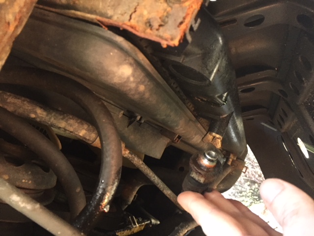

This morning when I left my house I heard what sounded like water swishing back and forth from in front of the vehicle. When I got to the store I noticed coolant streaming out from under the front skid plate on the passenger side. Unfortunately I can't get the skid plate off due to the shop that changed my oil last must of used a torque gun to put it back on. I broke 2 sockets trying to remove the bolt.
It's been sitting for 3 hours now and is still trickling. I put a coffee can under it to catch the coolant and the large can is about half full now.
Any ideas what it could be?

Could be the lower radiator hose, the radiator itself, water neck that houses the thermostat, water pump, or maybe the oil cooler hose.

I'm hoping its just a hose. I'm fearing its the heater core but the inside of the truck is dry. I had one go out on me in a 91 Sonoma and the carpet got all wet and it fogged the windshield.

Not yet. Heading out this morning to pick up a new socket. I leaked another coffee can worth of coolant over night. I just put a 3rd can under the truck to collect the drips.

The good and the bad
Bad News: I need a new radiator
Good News: It's not the heater core!
Great News: It looks like I avoided a strawberry milkshake due to the information on this forum. The leak is coming from a rotted fitting on the abandoned transmission cooler.
I'm 40k miles over due for a timing belt and water pump change. both were done a little over 100k miles. Im not at 240k on the truck. Might as well get it all taken care of while the radiator is being replaced.
Thank you everyone who's share info in this forum. I don't post much but I do read it whenever I need info on something. Its a great source of information.
IDK why the pic is displaying sideways. It's normal when I open up the file by itself.
So you installed a transmission cooler and the tranny cooler part was already bypassed on the radiator? thats is crazy. Guess a little piece of you feels good knowing you know it failed and you saved your transmission.
Yes. I installed a B&M cooler 4 years ago after reading about it here. What you see in the pic is a piece of the old line that I used to connect the 2 bibs on the abandoned stock cooler just in case of a failure in the upper part of the radiator. One of the bibs rotted off and thats where the coolant is leaking from.
240k+ on the original radiator.
