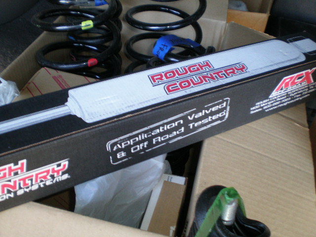

Took a box a stuff to my mechanic today (Included front/rears 99' coils, new brake shoes, new pads, set of rough country Nitro 9000 rear shocks and struts). Big thanks to ryanmaksuda for the coils, and Chris (aka 01t4rnr on here and also works at Rock Mountain Suspension) for the deal on the RC Nitro's.
My mechanic got all the brake work done, including resurfacing the rotors and drums, and got the coils, shocks, and struts in but unfortunately he wasn't able to get the front coils back in with my daystar 1" spacers up front (I don't think he completely disassembled LBJ's, or endlinks, or swaybar or whatever needs to be done to get enough clearance) so it looks like i'm going to have to find a way to do this on my own (hopefully with some help from some fellow members :D ) I need to swap out my swaybar bushing for some Energy suspension poly bushings anways so maybe i'll be able to get it done at that time.
BTW, here's a link to Wheelersoffroad for anyone interested in the shocks/struts, but I would recommend ordering from Chris at Rocky Mountain, he'll hook you up any way he can, just let him know you're a member here.

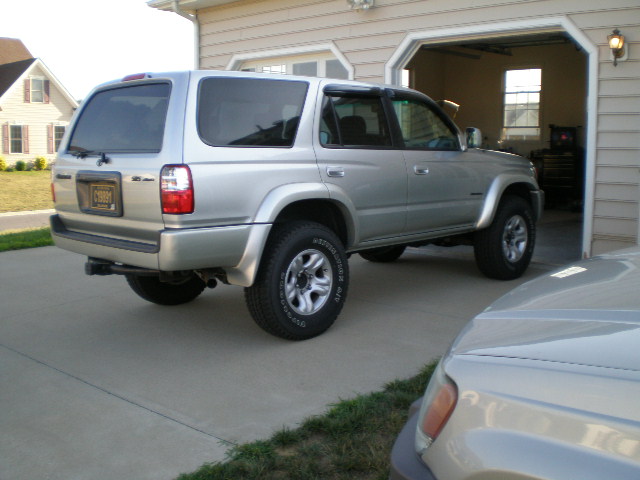

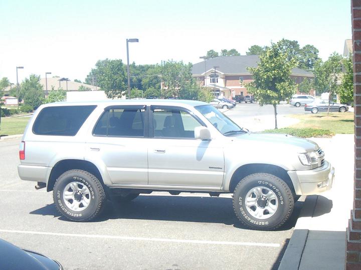

Anyway, here's a pic of the day I brought her home (pic #1) compared to the after with the 99' coils and the new Rough country shocks/struts (unfortunately no spacer yet) :(

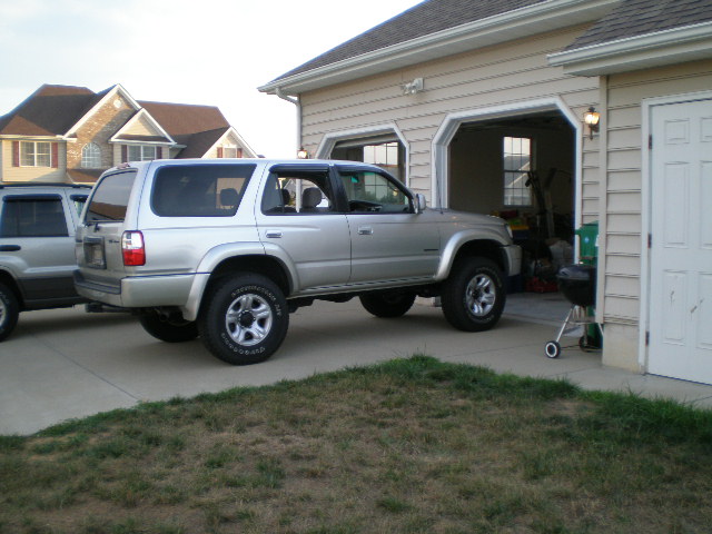

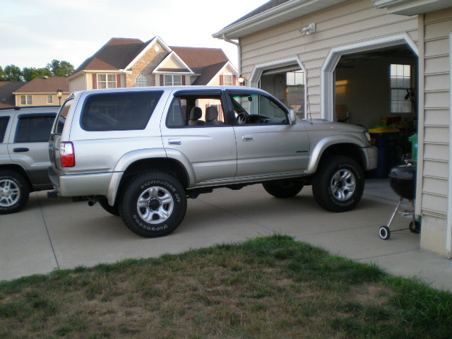

Anyway, here's a not so good pic, but i'm hungry and tired and i'm spent at the moment so i'll post some more tomorrow.

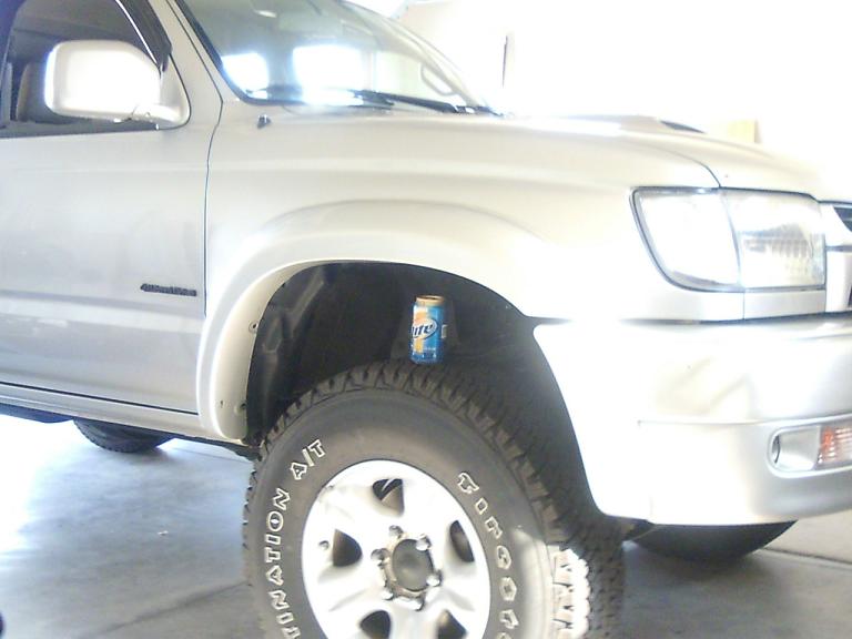

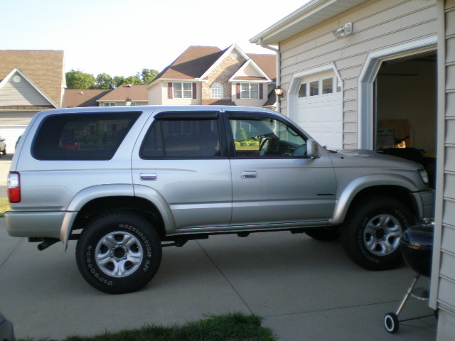

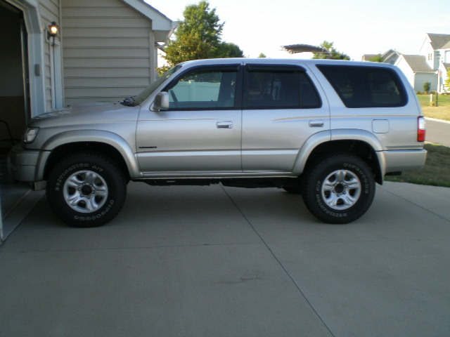

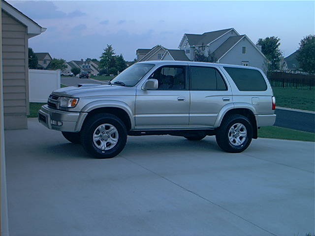

Here's a pic I took yesterday while I was at work (pre-spacers). The 2nd pic I took today after I finished getting the 1st spacer in :D
Looks great! I just got some '99 coils the other day, hope to get them installed in the next while with some new LBJ's, and a few other things. Could you measure from the center of the hub to the bottom of the fender flare? That way it doesn't matter what wheels/tires are on the truck, anyone can directly compare the lift you've got with their own.
Here you go Ian:
Front DS = 22.75"
Front PS = 23.25"
Rear PS = 22.5"
Rear DS = 22.0"
About a 1/2 tank gas if that makes any difference.
