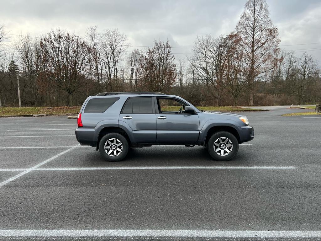

Update:
I installed without the spacer. It doesn't look quite as high or level in the front as it did with the old strut and spacer, but I'm glad I did it this way. I assume I would have been another couple of inches high in the front if I did, and it would definitely be nose-up.

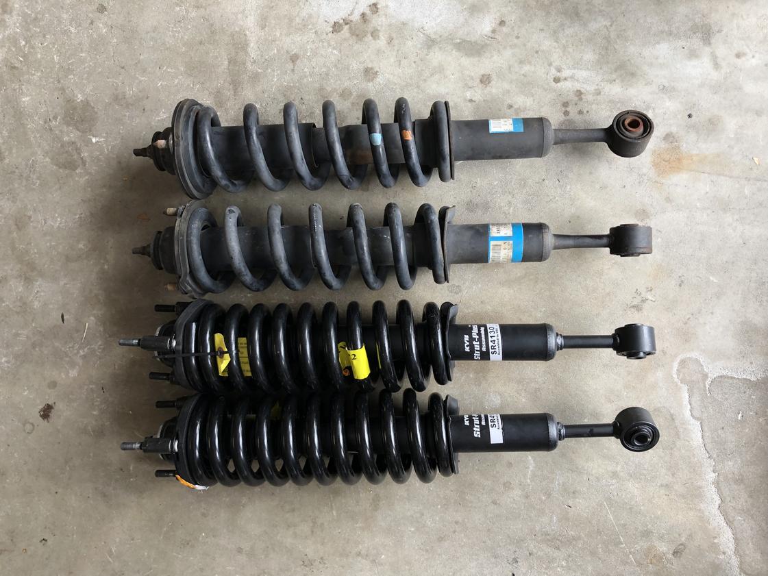

Interesting comparison between the KYB springs and the OEM springs. Though the struts are the same length, there are more coils on the KYB springs which I'm sure affect the ride height and the firmness of the ride.
Stole a picture from another user to show the difference...
Hi, just now seeing this and wanted to give some info on installing the KYB on my 08. I posted in some other threads a couple years ago with before/after pics, I got about a 1.25-1.5" lift in the front going from 140k mile XREAS shocks, very happy with the height & ride on a mostly street driven 4runner, rear is stock springs that sit good, front is close to level but not quite, i prefer a slight rake too.
I talked to KYB before buying to get some info, they said the shock valving and springs are about 10% stiffer than OEM. With a lifetime warranty teh KYB were a easy choice for me... 3+ years later they are doing great.
