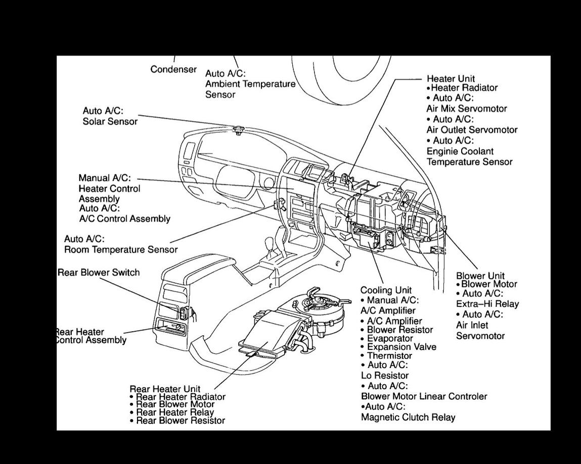

Looks like it's on top of the heater box? Might be able to get from glove box?
Will be called "Air Mix" Servo
Not sure, never had to look myself, maybe someone here has and can guide you in a better direction?
Picture gives you rough idea about where it is..
