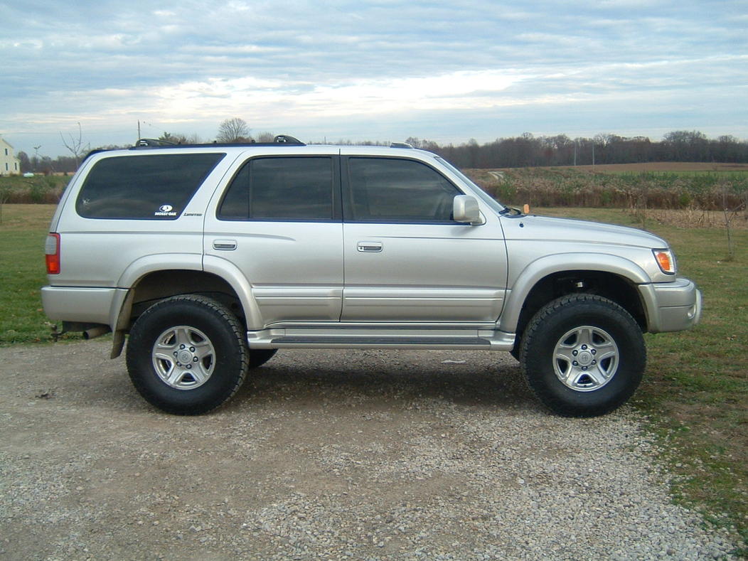

Just put lift on my (4th Runner) 99 Limited that I scored last year for $4250 at reasonable 153k miles. Lift consisted of FJ80 rear coils to replace originals and aluminum spacers in front along with some new 285 75 16 Nitto Terra Grapplers. Looks great but slight rub on A-arm. Should I do 1" spacers and if so, where is best and cheapest place to get them. Also, how about those running boards-loose them or keep em. I can't decide. I live in NE Ohio and it sees alot of salt and rocks in the winter so could not decide what to do. Keep em for the added protection or loose them for the looks??? By the way, rides great with lift, no dissapointments. I did add some tinted window visors too today and plan to put the front diff drop kit in also. May powder coat rims black next! Any thoughts???

looks good!
check out burtmanindustries.com, he has the spidertrax spacers in stock, which I've heard are the only ones that work correctly on our trucks
Thanks, other guy's reply linked me to same Spidertrax spacers. They are however about $98 a pair. I saw a complete set of 4 on eBay for $119/free ship. Both Billet Aluminum and can't see how much difference, but what do I know about spacers?
1'' would work but i rather not have the tires stick out that far 1/4'' seems to be working just fine for me

I love the look of the Running boards and the flares on your Runner. 1) They help protect the lower part of your doors and rocker panels (I don't have them, and have tons of small pits in the paint on those spots) 2) I find they just look better!
Also, I wouldn't powder coat those wheels, I find they look great the way they are, (but I like silver or polished wheels) If you really want a black rim, why not just put down some cash on some wheels with a 4.5 inches of backspacing?? You won't have to buy spacers, and could use the money that you would have spent on spacers and powder coat, and just find a wheel that you REALLY like??

yeah, wheelersoffroad.com have 1/4'' spacers for 5.00 a piece, i think thats all you'll need, but i'm no expert? i just ordered a 3'' lift today, i am plannin on selling my 265/75s and buying some 285/75s, and i heard that the width on the 285s are super close to the control arm on factory 16x7 wheels, so i am just gonna get those 1/4'' spacers, should be fine. soon as i get it all done i'll post a pic. maybe that'll help.

I believe the .25" plate spacers like wheelers offroad sells work ok.....its the bolt on spacers like spidertrax and all pro that aren't hub centric and lug centric that don't work. Most people do Spidertrax because they're hub and lug centric

Spidertrax is NOT the only ones that work correctly on our trucks, I have trail gear wheel spacers and they work fine.

Went with Trail gear since they are cheaper than the Spidertrax, and if needed they offer sizes from 1"-3".

You really should run longer studs, I had a .25" spacer on my Tacoma and I was snapping wheel studs left and right becuase there wasnt enough thread, I just dont trust them anymore. I found that the rear wheel studs are longer, they arent a .25" longer but they are definitely better than just throwing spacers on the front without doing anything. I would either get some wheels with a 4 inch backspace or go all out and run a 1" bolt on spacer. Thats just my 2 pennies..
