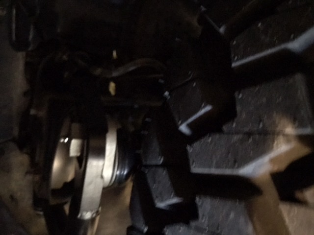

Just put on some Nitto Trail grappler 285/75-16's on my 99 limited with stock 5 star wheels and 3" lift. I have already noticed right frame and left UCA rub at full lock to the right. Full lock left appears to be clear. I hit both UCA's and full drop. I also think I am going to rub inner wheel wells at a minimum with the wheels stuffed.
Where do I start resolving these issues? I think I can deal with the frame rub, but the UCA clearance needs resolved. I would like to keep the wheels and avoid spacers if possible. However if everything can be resolved with new wheels or spacers then so be it. I will explore those avenues. I do want to do it once and do it right. I have had this rig for a long time and plan to keep it as a toy for off roading.
Will SPC UCA's provide the clearances at full drop and right turn full lock or am I wasting my money starting with UCA's? I also read the SPC UCA's will allow to move the wheels forward providing firewall clearance. Is that accurate? SPC UCA's are now around $600. For another $150 should i go ICON? From what I have seen they won’t move the wheel forward enough.

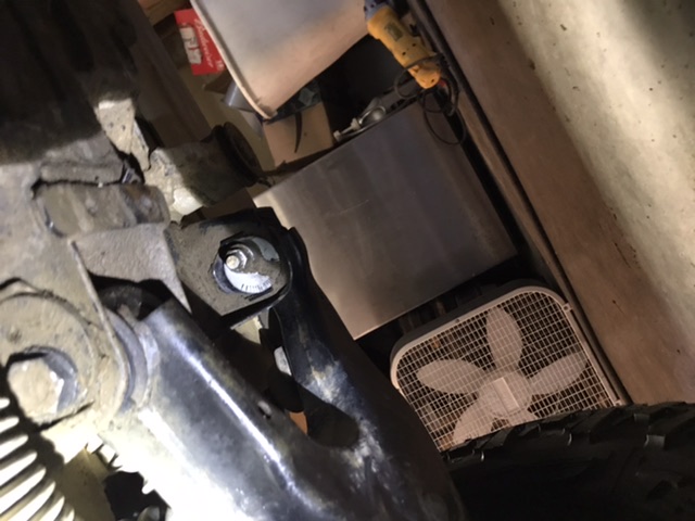

I got the spc’s in last night. I got lucky with the ubj’s. They pressed right out. I adjusted my cams front in, rear out and it appears to not have moved my wheel location at all. Can you tell from this pic if there is any more adjustment or is it maxed out?
This is the drivers side. On the passenger side I was able to get the rear cam all the way out but the front would only move about half way there. Trying to get it all the way it seamed to bind up and rotate back. Not sure what’s going on with that one.

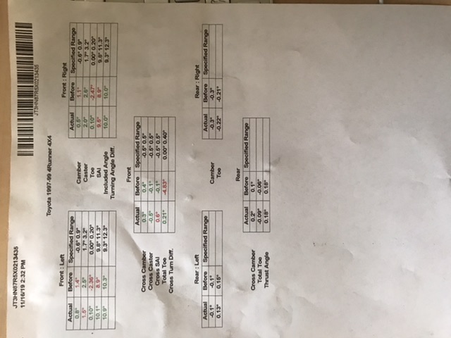

I went ahead had the alignment done. Here are my final numbers.
I will say these uca’s accomplished my goals. I no longer rub at either uca nor the passenger side frame. I also stuffed the wheels and have no rubbing. I have not had time for a full road test yet.
