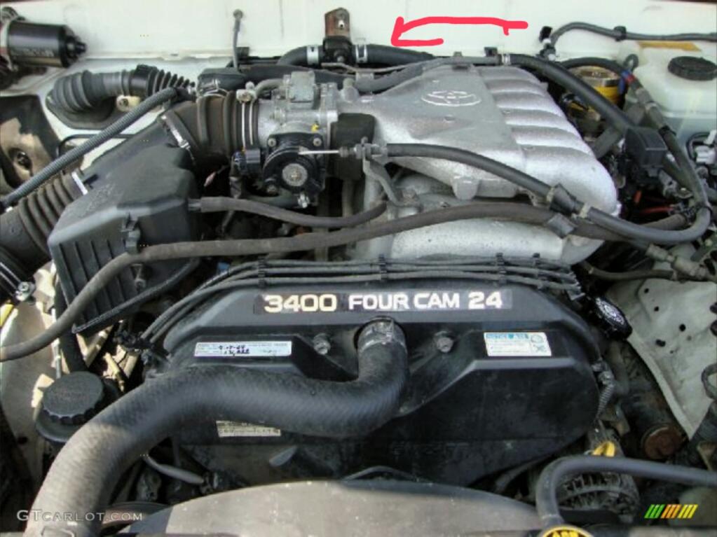

The image attached shows which line came off.

The heater valves used on the 4Runner are the same ones used on the Land Cruiser, second gen 4runner, Camrys, other mini trucks, and I would assume, a good number of other Toyotas that I haven't been under the hoods of.
We've seen a rash of them going out on Cruisers and mini trucks lately, with something like four or five this summer. One of which was out on a trail and had to be bypassed to get back home. Not the most comfortable solution as it leaves your heater on, even if a little bit, for the entire drive home (you have to fold the hose over and kink it just right, but it will not be a 100% stop of flow). I wouldn't buy the dealer heater valve; the best replacement we've found is from Parts Authority for around $20. If the valve is failing or has failed (blowing the hose off is typical of valve failure, from what I've seen), it could explain the reason for the heat not working once filled back up. I'll check at the shop today and see if I can find one of the blown out valves to take a closer look at how well it works and it's overall shape.
I'm not saying this is the problem, but it's worth mentioning that these valves are starting to become a weak point in Toyota coolant/heater systems. This isn't a flaw, just a part that takes a lot of abuse and gets tired. The hose that blew off is the same side that is blowing out on trucks here in Phoenix.
