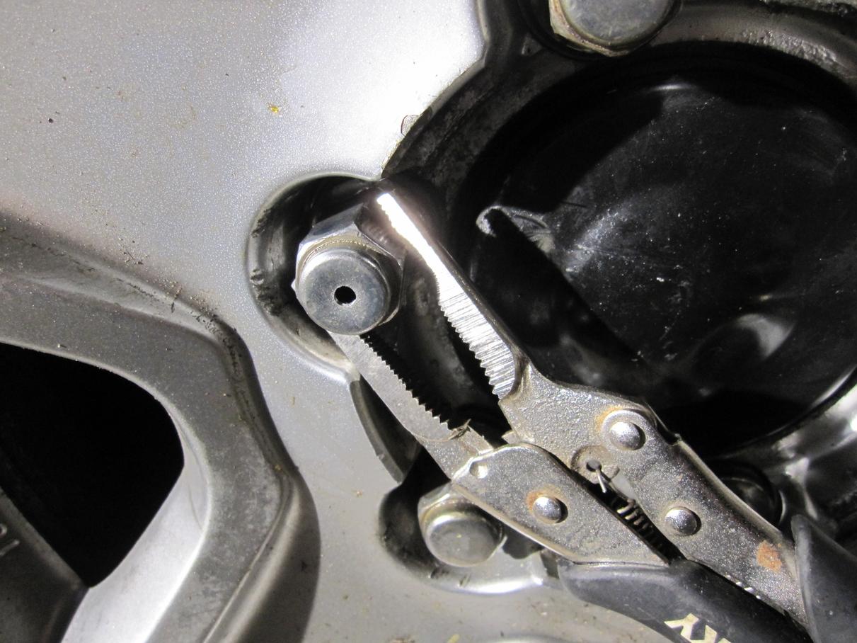

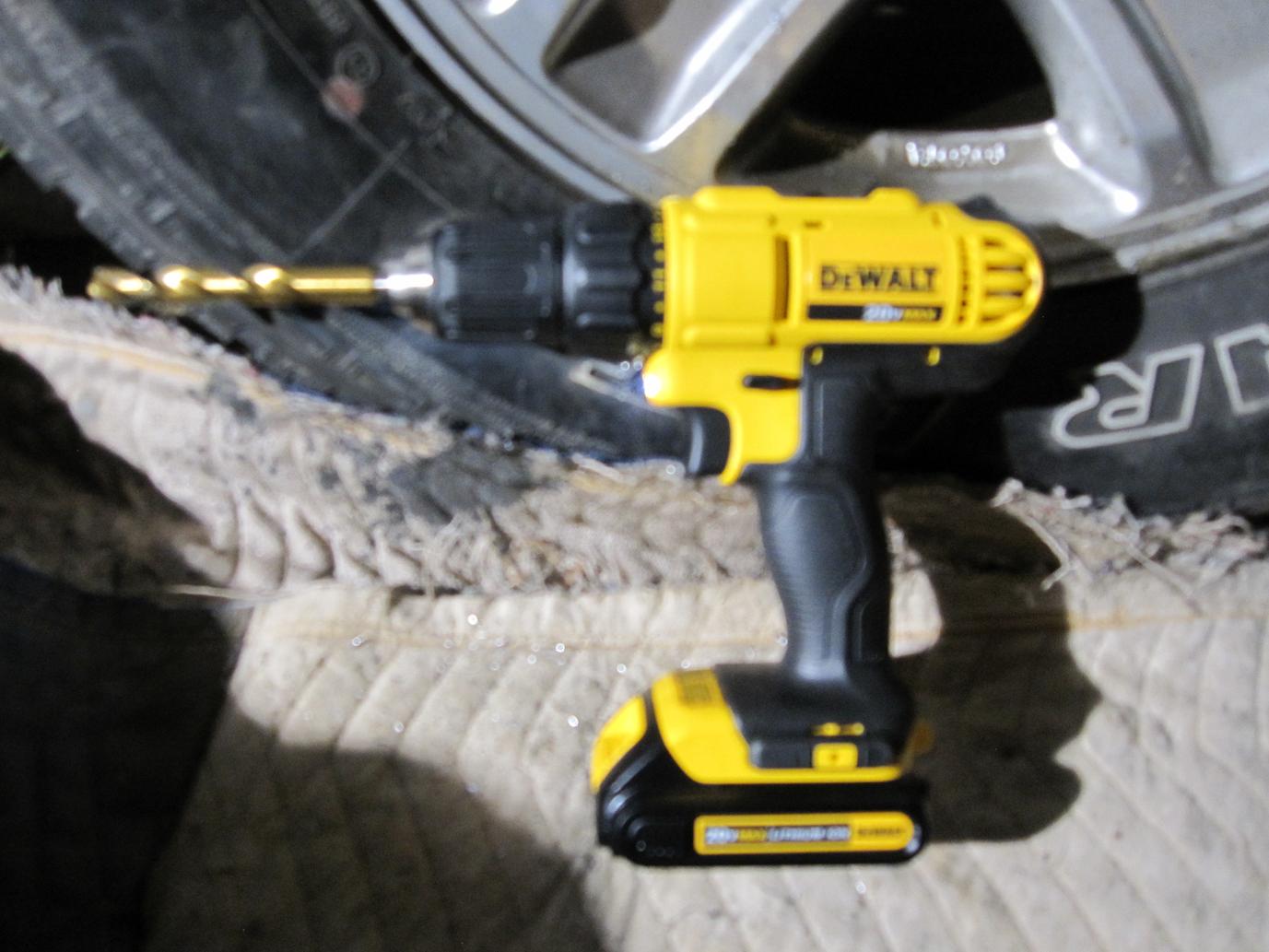

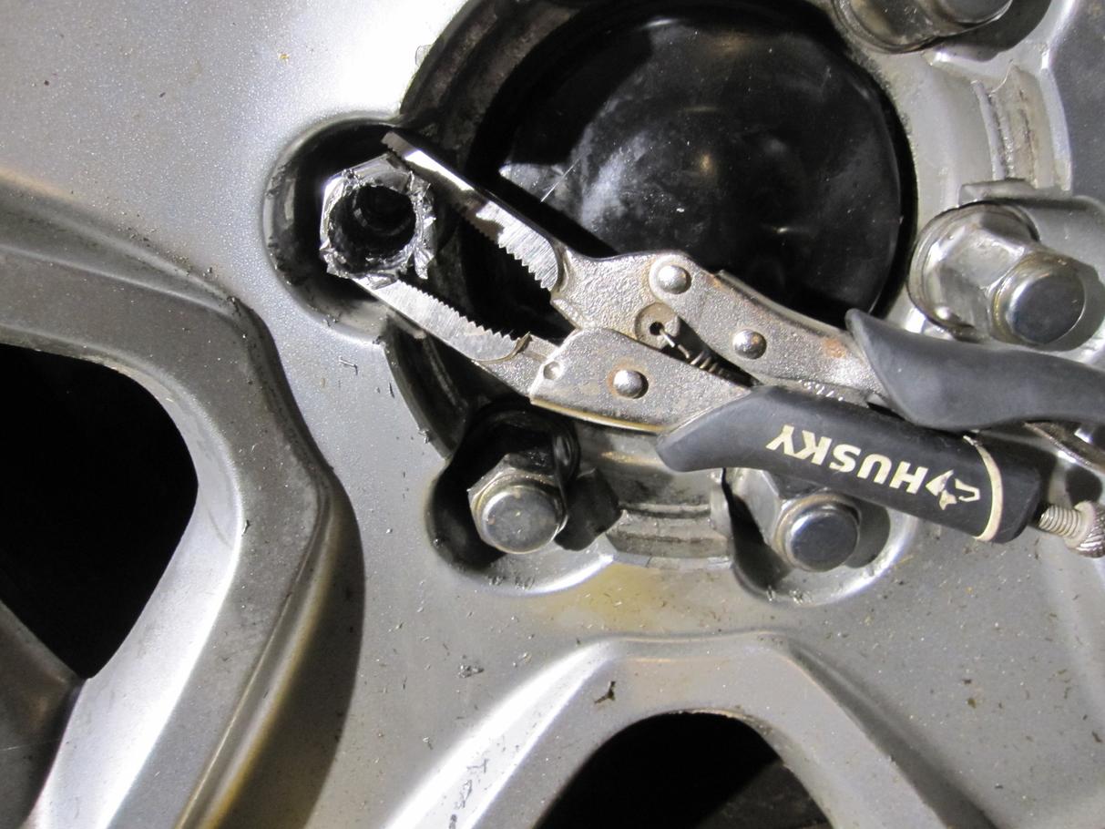

I busted a wheel stud the other day on my Limited, I was pissed. I didn't want to deal with it & was gonna drop it off at a mech the next morning. I figured it would be around $200 for him to drill it out & put in a new one. I slept on it & the next day I said f#ck that! I bought a new DeWalt 20V 1/2" cordless, titanium drill bits & some washers. I drilled it out & put in the new stud in around 2hrs. I saved $100 & have a nice new bad ass drill.
(my 3 old corded drills dont have the torque for hardened steel & would have made the job a nightmare)

DUDE, why did you drill it out? You could have just hammered it out with a cold chisel lol they will fall right out with one or two whacks. You make a great point on justifying tool purchases though. I try to explain that to my girlfriend every time I buy a new tool! She doesn't get it.
I hear you but the wheel & lug nut were still on. I had to drill through the lug nut with a 1/2" bit to destroy the threads on the lug nut.
Oh I gotcha, your stud was spinning with the nut. I thought you snapped your stud, and made more work for yourself lol :doh:
