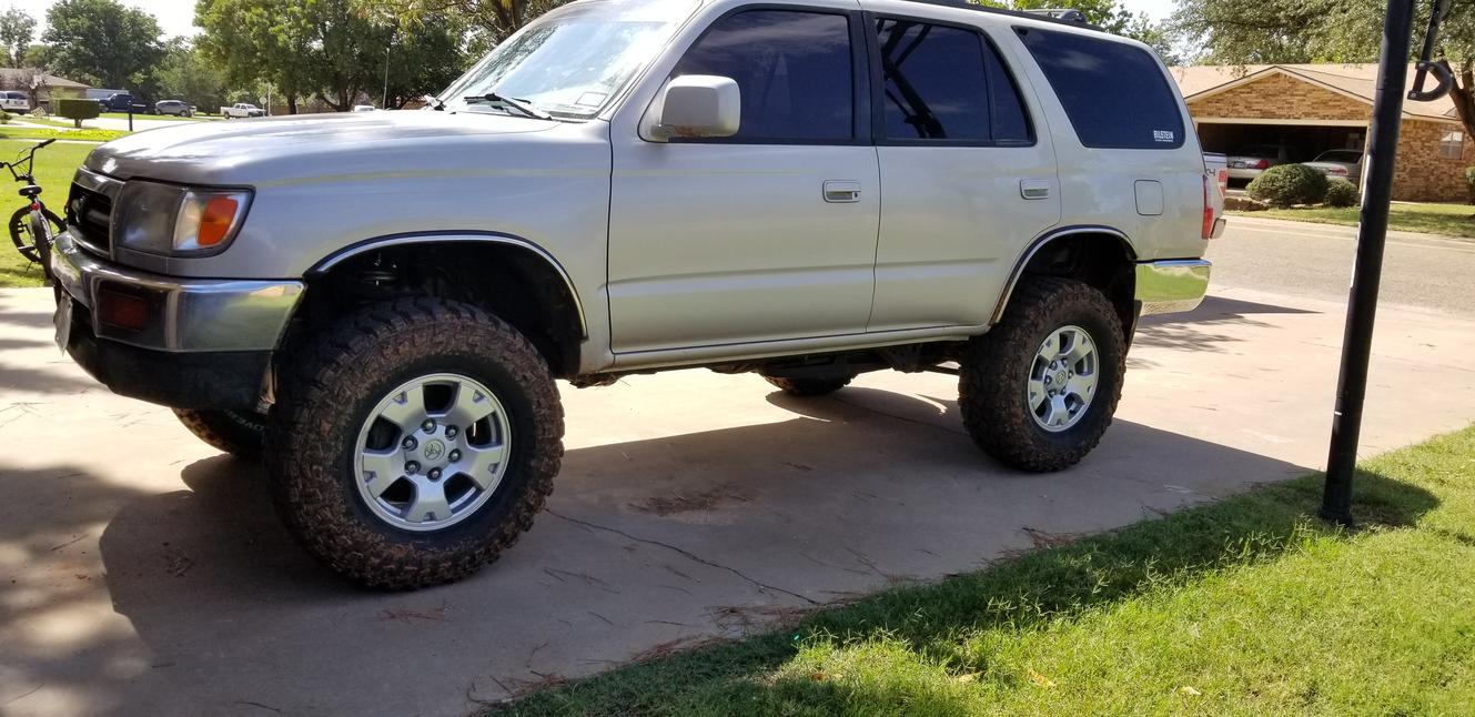

I just put toytec/eibach with tundra 5100s front and OME 891 with tundra 5100s rear last weekend. I have nothing to compare it to besides stock setup, but I'm loving it so far!

That looks good, what size tire are you running, I’m currently on a 265/75-16 and hoping to go bigger

These are 265/75/16 Cooper Discoverer STT Pro, I did have to add 1.25" wheel spacers to keep them off the upper control arms. I read several threads that a few people said this setup was stiff, but I was running factory setup with yellow Bilstein shocks before this and I like the somewhat firmer ride. I DD a Ford F150 supercrew with a front spacer and add a leaf in rear and the 4runner isn't any stiffer than it is. I may or may not add a front ,rear bumper, and/or winch, but my theory is if I do then I don't have to replace my suspension again!
