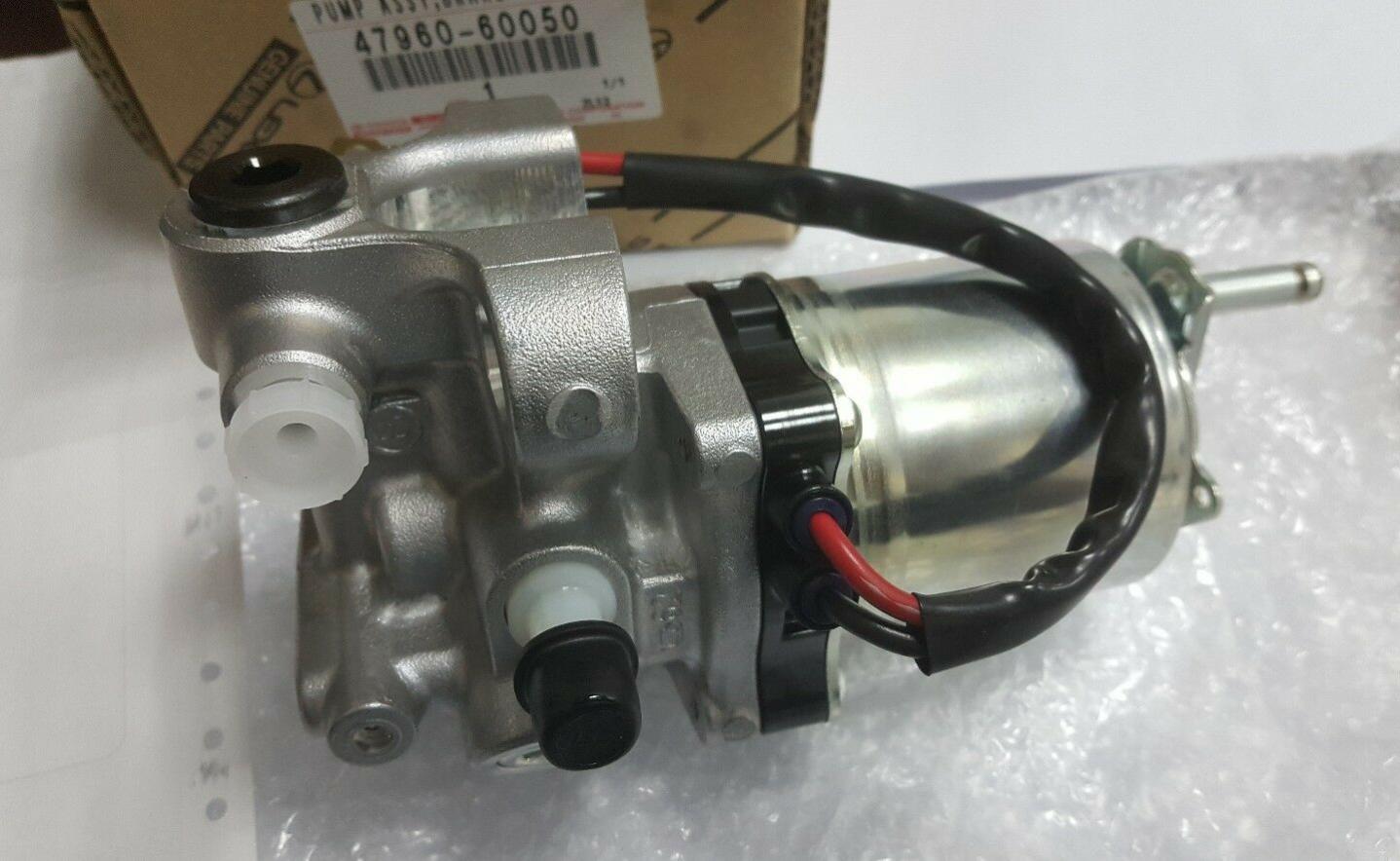

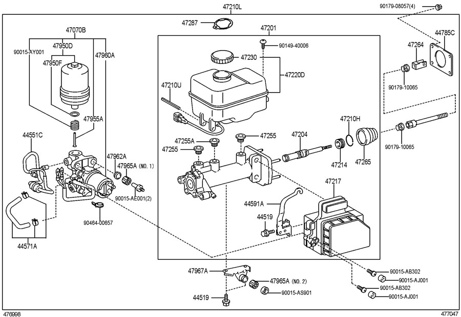

Now you need to do a little more investigating, go to your local auto part store and buy a "mechanic's stethoscope" for about $10 or so, it looks just like a doctor's stethoscope except it has a long metal probe on the end used to touch areas when trying to pinpoint noises, then locate the electric motor on the master cylinder assembly, turn the ignition "on" but don't start the engine have someone depress the brake pedal several times until the motor kicks on while you are under the hood with the probe on the motor, you should hear the squeal loudly with the stethoscope if it's the motor, the electric motor/pump/accumulator assembly is on the passenger's side of the master cylinder at the back and underside.
I'll try and post a photo of the motor and pump assembly without the accumulator so you can see what it looks like, you can clearly see the wires coming out of the motor, the motor has a silver housing but your's is most likely has a black housing, the accumulator is a canister looking device that will screw into the plugged hole at the top left in the photo of the motor/pump assembly, I'll also post am exploded image of the entire master cylinder assembly, the motor/pump/accumulator is on the left.
