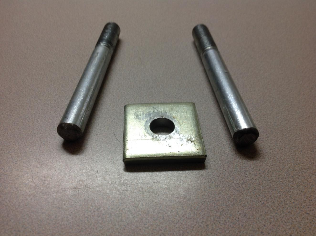

Things about mounting bumper there is no way to adjust body to bumper gap as it comes, it's awkward getting it mounted without dinging paint.
Before paint do a mock up, I elongated the six holes 3/8" that hold bumper to cross member so I could achieve the correct gap, no two Runners are the same.
Thin flat washers on these 6 bolts as designed is a weak link from the git go, elongating holes making it fit your Runner makes it worse.
Washers in pic are 1-9/16" square 1/4" thick stout, for ease of install 4-5/8" long bolts with head cut off makes a guide rod.

Along the same lines, be prepared to go shopping for fasteners to finish the installation. The original tie down bracket bolts are not long enough to properly engage with the added thickness of the crossmember, so I needed four 12x1.25-40mm flange head screws:
Also, at least in my case, the 1/2"-13 screws that were supplied with the bumper (to attach the bumper to the crossmember) were all cross-threaded, so I had to get six new 1/2"-13 flange head screws:

Those heavy duty square washers look perfect too. I will grab some of those. The guide rod - to line up the holes?

Those heavy duty square washer,
The square washers are used with Unistrut in electrical construction local electrical supply has them.
The long headless bolt is to hang bumper on slide it into position in a controlled manner.
I had same problem with bolt threads as Spiker mentioned, get a tap to cut good threads
AOR must like using worn out taps.
