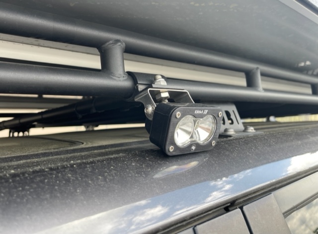

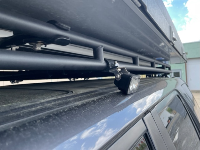

When I had my Gobi installed I ran one of the horizontal bolts for the front mounting feet bracket through the s2 mount. I had to open up the hole on the s2 bracket more to fit the lag bolt, but it worked perfectly. Fit below my ARB awning too. Best part is with a plastic washer in between I was able to rotate the s2 bracket and have the lights not only shine up or down but forward and backwards. No need for ditch lights then either.

Awesome. Thank you. Can I ask how you ran your wires for those?
Thanks again!
in a mesh loom, zip tied under the rack across to passenger side, combined with loom for passenger side light, zip tied under the rack forward to the windshield, down the windshield weather stripping, through the cowl and back across to an SPOD (drivers side windshield was already in use so had to go across and back through the engine compartment)
similar to [MENTION=144133]JPOVS[/MENTION] cool idea, this low/upside-down mount allows the light to fit below an ARB awning

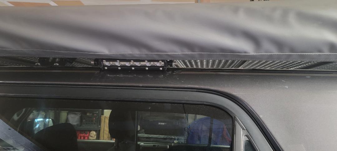

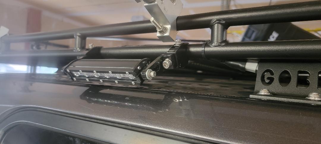

I'm doing something similar to [MENTION=127657]codyHTX[/MENTION].
The lights are from Stedi and the mounts are fom Axia Alloys.
On the driver side I Mounted it under the awning so it could serve dual purpose.
