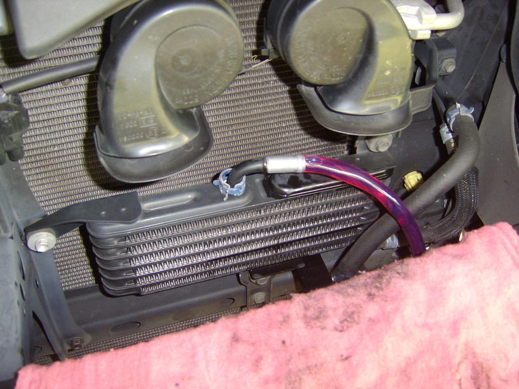

That smaller radiator in your first photo is your external trans cooler. The top hose is the outlet from the cooler back to the trans pan...ie. the return line you're looking for. Flow goes in the bottom of the external cooler and out the top. Pick up some 3/8" ID tubing, (HD/Lowes/etc), connect it in place of the top hose route to a bucket, and you're good to go for a cooler line flush.
The radiator sandwich front to back is, external trans|a/c|engine.
The full path on the V-8 is trans-> top passenger side of engine rad for first trans cooler in the engine rad->bottom of engine rad->under engine rad to driver's side->bottom inlet on external trans cooler->top outlet trans cooler->vertically down driver's side and back over to passenger side->back to trans pan.
-Brent

Bottom pic is the passenger side of the radiator which I'm assuming those are my trans cooler lines? Any idea which is the return?
They say a picture is worth 1,000 words...

I should be able to pull that cooler line, per the 1000 word picture thank you very much, run it till it sputters, then fill up the trans, run it once more till it sputters and then perform a final fill and level check. Since I have the sealed trans unless I drop the pan I really can't drain much of anything out of it is my understanding... In the end I should get about 11qts of old trans fluid out???
As the weather is getting better, I plan to do this flush very soon.
My question refers to the pic the riverwolf posted. With the clear tubing attached to the return line and dumping the used ATF into a container, can you then put the black hose into a container of fresh ATF and have it draw the fresh ATF right into the tranny? Would the black return line produce sufficient suction to do this? If so, you could then do the whole flush right from the front of the vehicle.
