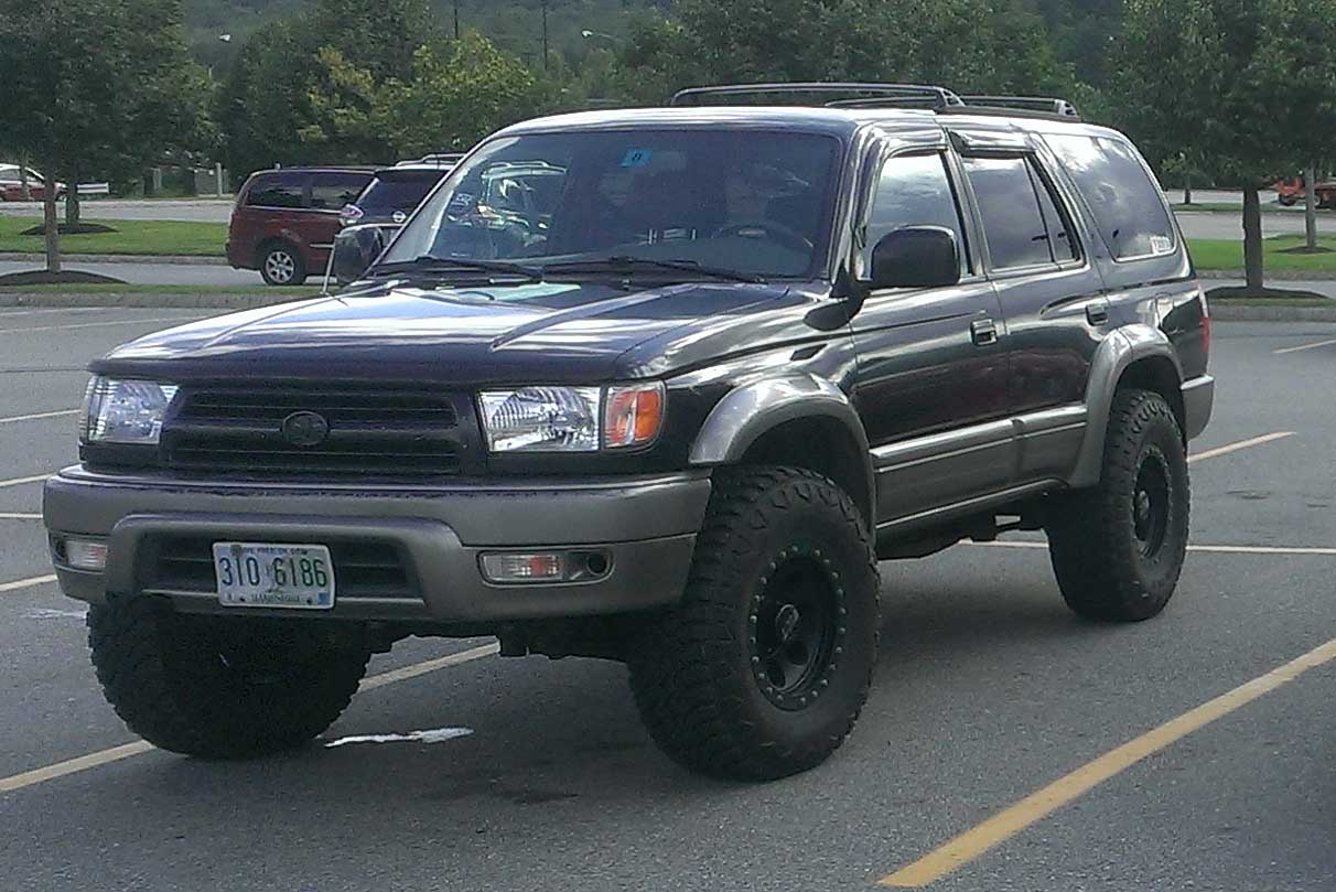

The first picture is of the original stance of the 4Runner when I bought it (with 285/75R16 Pro Comp MTs on Black Micky Thompson Classic Lock Wheels). I wasn't a huge fan of the wheels and wanted narrower tires for better highway snow performance so I swapped to the "OEM" wheels provided when I bought the truck and bought new General Grabber AT2 tires in 265/75R16 (note that the "OEM" wheels are actually Tundra wheels from the era).

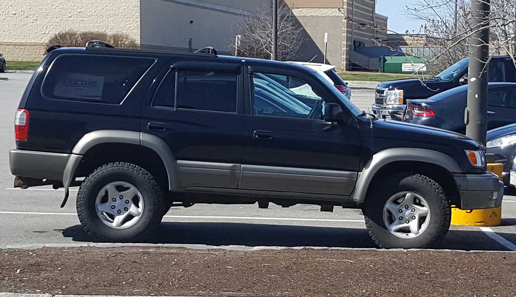

The second picture shows the new stance after I had the struts installed, you can see that the front is much lower now.

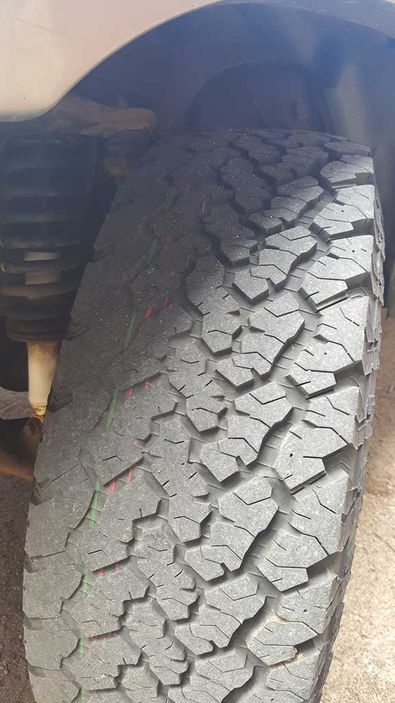

The third stance shows the wear on the inner corner of the driver's tire. Both front tires are now bald on the inner 3in or so while the rear tires have less than 1/32 of ware.
