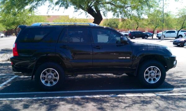

My truck with the Toytec Ultimate. Stock Tires/Wheels. Mine dont have much longer so Im just going to wait to replace them.

Yeah, you need to rid yourself of those pooky tires and get some 285's.
Oh trust me after going out last weekend its one if the first things on my list. Just waiting for school to start up so I start getting an income with my GI Bill. Tires most likely have enough tread to last till the end of the year but not much more.
