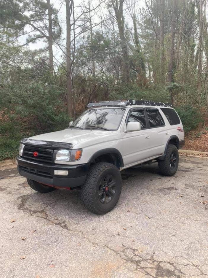

This is what I got for $6300 high miles.. 227000
Stats:: 1998 v6 TRD SR5 Leather~with around $9000 put into it in last 2 years of my purchase in Jan 2020 for $6300.
New heavy duty alt, starter and battery
2018 wheels and tires (12/2019)
New disk brakes all the way around
New Headliner
New water, oil, fuel pumps
New condenser and evaporator
ScanGauge diagnostic scanner
New pioneer Bluetooth stereo and speakers with added tweeters
Timing chain, tensioners, and valve cover gasket
Rocky Mountain Rack n' coon huntin lights
New mini radiator added for milkshake prevention
All new weather tech mats including rear storage area
New Led headlights and tail lights
New front and rear bumpers.
Total score on this vehicle. Runs fantastic!
In very fortunate to have found it. Very happy for sure.
