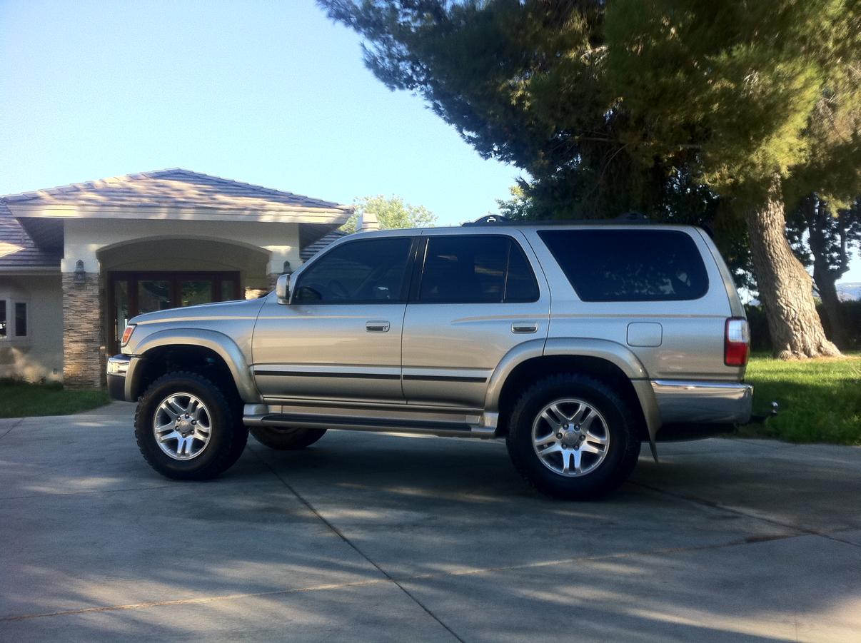

Hi, i have an 02 4runner with king coilovers in the front, and the back is stock, running something like 265/70/17, i want to be able to put 2 sizes bigger or roughly 2.5inch bigger tires, does anyone know how much i can raise the front since its 4wd with out messing anything up, i already have a 1in diff drop, but need to know how high i can lift it in the front before i will get any problems, or what will need to be upgraded to lift it higher, also i want to lift the rear 2in, can i just change out the coil or do i need to do the shock as well? any advice?

Since you had a diff drop then you can lift it up to 3 in and be fine but I would not recommend spinning the coil retainer on the kings all the way to the bottom cause you will have no droop travel and the ride will be harsh. You should be able to adjust the retainer 3/4 of the way down and clear a 285 which is a 33. As for the rear you are going to need longer rear shocks once you put new coils in. If I were you I would look for a set of Land Cruiser front 7 wrap coils which give you a 3" lift in the . Thats my plan because I am putting icon coilovers in the front and lc coils in the rear with 33's. Good luck
...running something like 265/70/17, i want to be able to put 2 sizes bigger or roughly 2.5inch bigger tires...
That's not going to happen without hacking the fenders and the firewall and rewelding new plates on the firewall. You can go up to a 285/70/17 which is a 33 (like Phd said). you are running about a 32 right now so you'll be able to go 1" larger with a 3-4" lift. 3 is about the max lift you can do in the front without risking CV axle issues.
What Phd said about the coilovers is right on too. If you adjust the collars all the way down you will ride like crap and also you'll be maxing out your droop at all times and constanly stressing you CVs. You'll also need longer shocks in the rear so they don't break when you flex out.
my front is at 39" with 285's if that gives you something to base it on. 3.5" is prob. the most youd want to go
