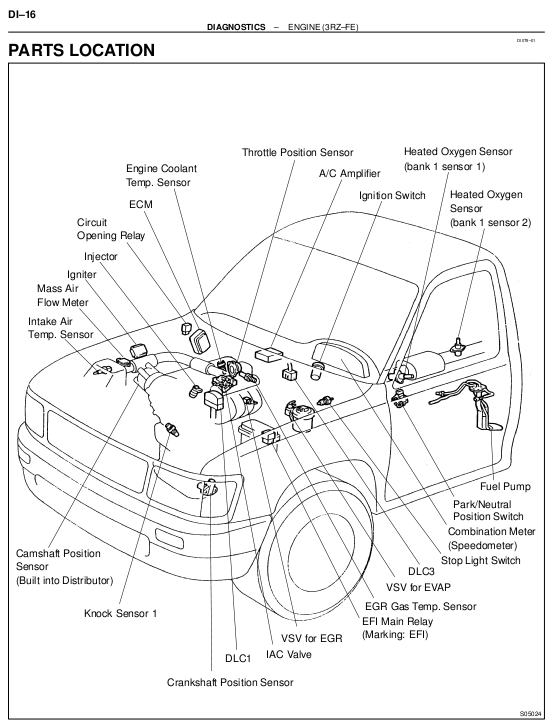

not to familiar with 02 placement on the 3rz, but mine is right before the cat. have you checked there for it?
I looked but I must be looking in the wrong location for the oxygen sensor.
This diagram in the attached troubleshooting guide seems to intimate they're under the driver whereas I thought they were in the engine bay.

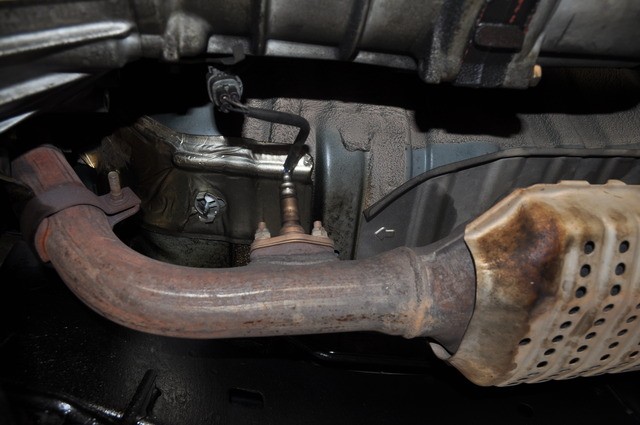

I followed your advice. It was EASY to find once I shut the hood and looked up instead of down from the engine bay!
BTW, I checked the codes today (after almost 100 miles) and the registers are clear. That's odd.

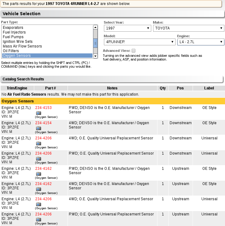

Anyway, following TheDurk's link for Denso sensors, I found the part numbers to be:
234-4162 3RZFE RWD upstream Denso (crosses over to Carquest 75-1804) $122.oo
234-4206 3RZFE RWD upstream (longer pigtail to fit more models, the guy said) $130.oo
They're $213.02 at the local Toyota dealer.

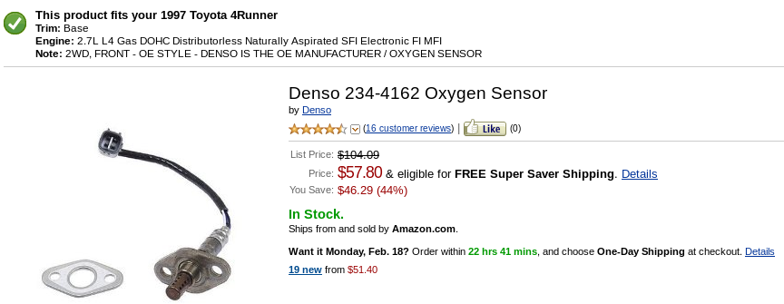

Your "guy" don't know jack. The 4206 is a "universal" fit---it has just the pigtail. You have to solder it on to your old plug. It should cost less, not more. WTF?
Meanwhile, Amazon has the correct OE style (with plug) 234-4162 for $58. You could get overnight shipping and be less than stinking Carquest.

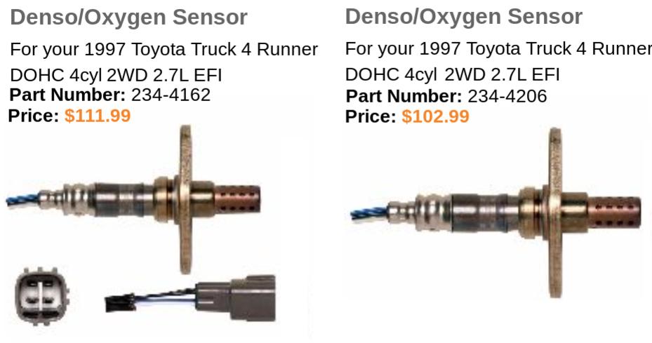

You are totally correct!
The Carquest guy gave me bad info. Forewarned, I asked at Autozone, who said, as you did, the "universal" o2 sensor has to be spliced, and, their universal denso sensor, as you said, cost LESS than the exact fit.
Upstream Denso O2 sensor for 3RZ-FE 2WD manual 1997 4Runner:
234-4162 $112 (OE connector included)
234-4206 $103 (OE connector not included)
Will try Amazon as your prices are a LOT less!

I bought both the upstream and downstream Denso O2 sensors W/OE connectors, from Amazon in Sept. 2011, for $109.00 shipped for both.
I looked at it as getting both for the price of what one would have cost, at a local parts place.
The picture of your upstream O2 sensor shows the existing nuts holding the sensor in place, are in great shape. No need to replace them.

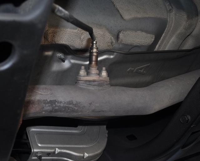

Here's a shot of the downstream oxygen sensor.
Note the nuts look as good or better than the upstream one (this is a Cali car).
