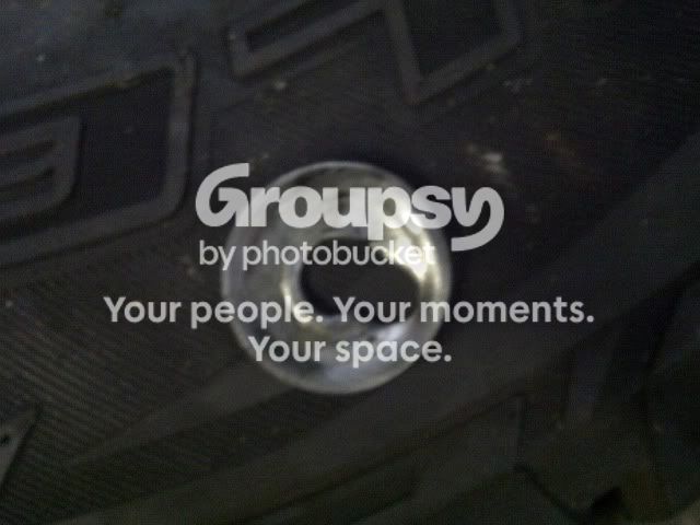

I just installed the Toytec ultimate lift with the 5125's in the rear and mine came loose about 500 miles after the install and I think they are coming loose again. I'm leaving for CO from Chicago at 4AM and I'm trying to get this figured out. Other than tightening them as much as possible (which we did the last time) what else can we do to get them to stay put?
Also, when they are tightened down, should you be able to turn the upper portion of the shock? Because I can :violin:
It sounds like these nylon nuts aren't the best. This is the third post I've seen about the same issue I had a few months back.
The worst part is that after I tightened them up a few months ago, they're loose again. I'm headed to Toytec to have a chat and see if they can assist because I sure as hell needed a lot of help installing the damn things in the first place.
yeah that nut on the top of the bracket really does SUCK~!! i put a lil bit of locktite on mine, so far so good...
sounds like what happened to mine...
