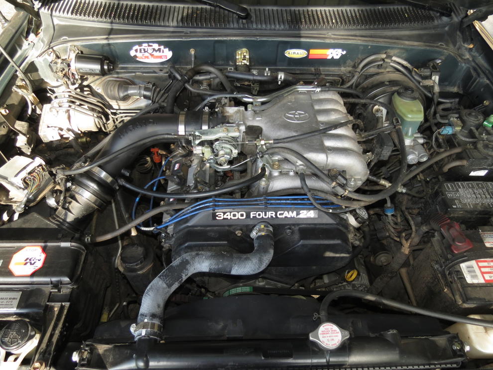

Heres a shot of mine. I usually fill up on Sunday nights and by Friday after work I'm down to 1/4 tank. With the ISR mod I would end on Friday with just a hair under 1/2. I really happy with the turn out, even if it is expensive.
Wow so you actually get a pretty good boost in mileage then with the Airaid on there.
