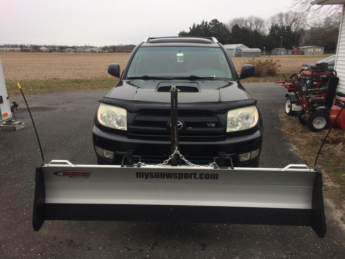

I use a Snowsport hitch plow on the front of my 2005 4Runner Sport. When I drive on the highway with it, let's say to go plow out a friend's driveway, the external temperature sensor will eventually read 100+ degrees when it's actually near/below freezing. While this is happening, the temp gauge does NOT indicate any significant increase in coolant temperature, if any.
Is this a potential overheating problem? To curb this, I have been pulling over, popping the hood, and allowing the external temp sensor to reach the actual outdoor temp before continuing on, but is this necessary? Or is there something that could be damaged by excessive heat in the sensor area?

I wouldn't worry about it. With the blade attached, the external temp sensor is seeing more heat from the radiator. Nothing to worry about.
Now if the engine temperature gauge on the dash was going up, that's a cause for worry.

I'm in Delaware, so we only get 6-10" max per storm. The usual snowfall is around 3-6". I plow my 100 ft driveway and some neighbors and other friends that live a town or two away. It has never failed me. In short, I absolutely love the freaking thing, especially since I added a winch attachment last year (made it myself - I'm definitely not paying $500 for the one they just released to market when I made my own for a little more than $100 bucks).

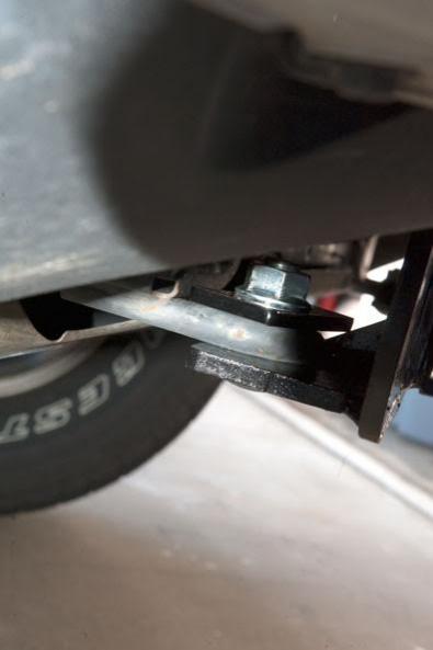

Prices have gone WAY up since I purchased mine years ago - at least $500 from what I have seen. I did purchase mine with a front hitch, but I have a 2005, and there is no front hitch made for a 2005, so I modified one made for a 2006. Had to cut the gussets, bend the tow rings brackets to the proper angle, and reattach (see attached photo from the guy who originally had the idea).
There are plenty of videos on YouTube showing people pushing some serious snow with it, but it's definitely not commercial grade. As long as I can clear my driveway and keep the big boys from plowing it shut, I'm golden. :cool:
