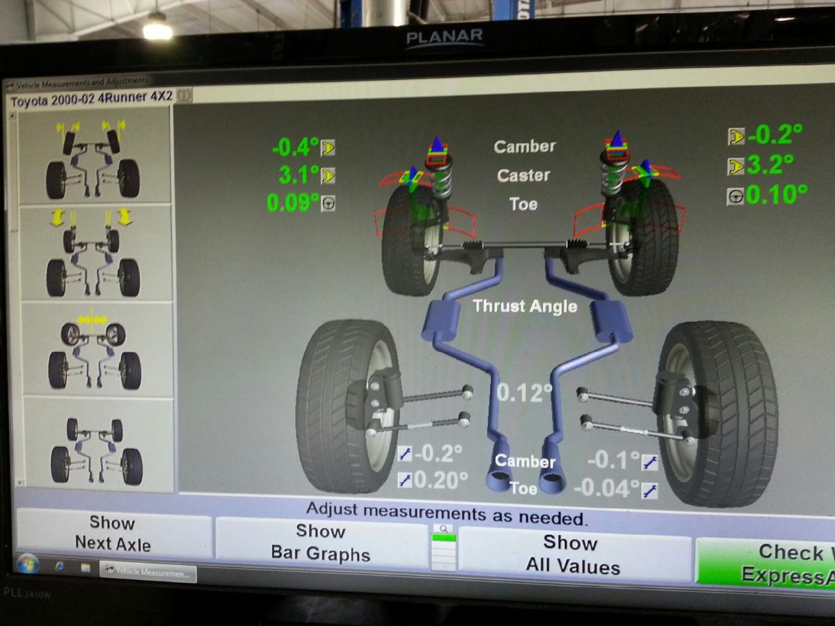

ok. after several phone calls, and finally having some free time at the shop, i ended up going to toyota to check/fix alignment. the wheels/tires weren't balanced properly either so i had them road force balance them. the service advisor gave a great deal on both so i had them done. i spoke to the master tech about what he did. he told me that the wheels/tires were good as far as road force is concerned but the balance was very bad producing a large amount of shimmy, which i already knew. the alignment was wayyy off as well and that surprised me as well as him. i told him that the last time i took it to the shop they told me that the thrust angle was off, causing the alignment problem. he didn't agree and said the rear was fine.
he showed me the screen after the adjustments and they are right on. he told me he drove it before and aft and it was night and day! he told me to go ahead and drive it and see how it felt. well, why i didn't go there from the beginning i don't know and doesn't matter now. but for $120, it is well worth it to me that the truck is the way it should be. mind you, the steering shaft has some play in it like most do, but it rides straight, the shimmy past 70 mph is gone and i don't even feel the tires nor hear them. it rides/drives like a car now. i have 30 days to complain about anything, if anything, so i am going to try and get the shaft welded and see what improvement i see/feel.
