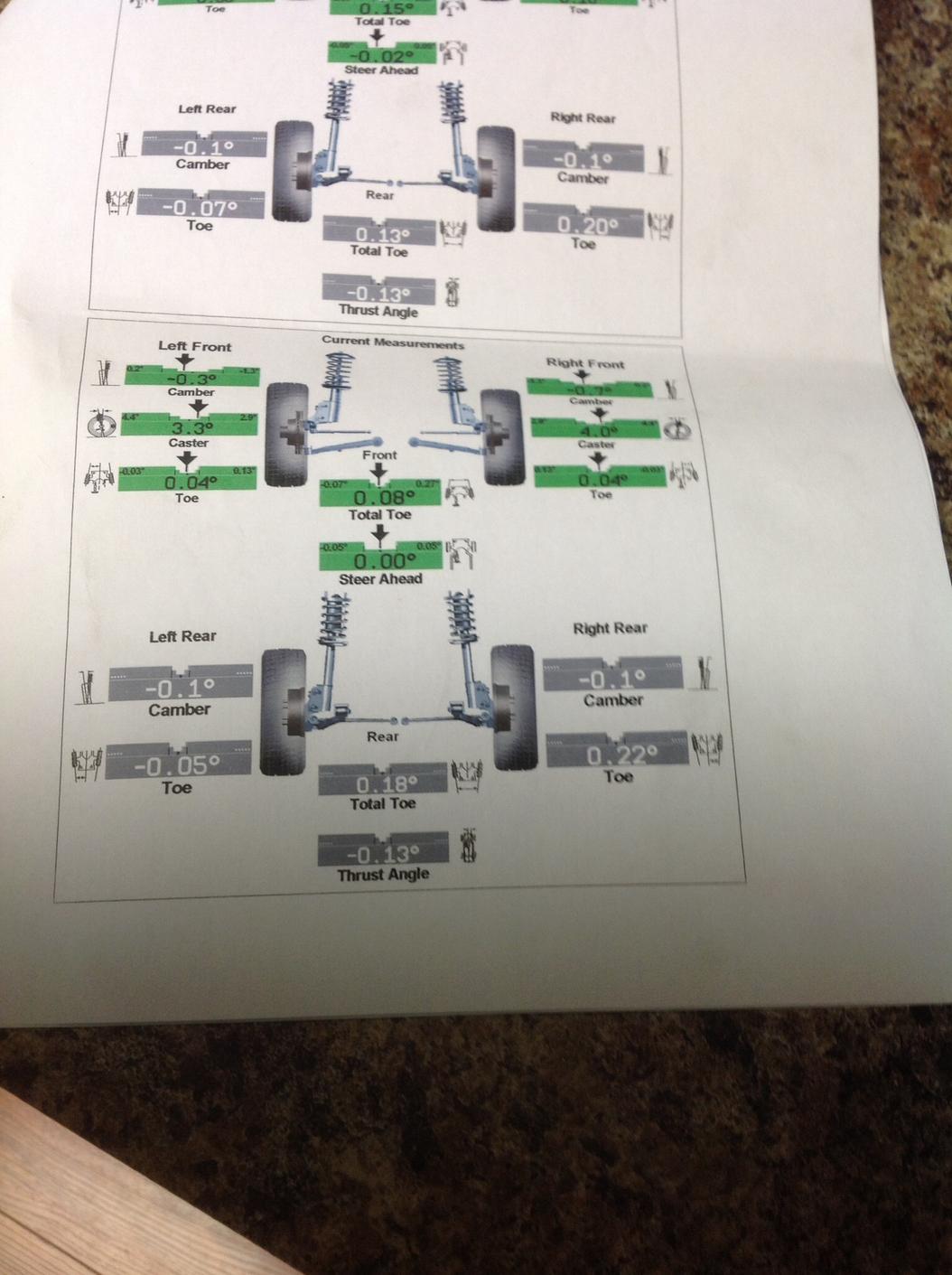

This is for all 4 tires? and even with no lift?
I too am wondering about this. I have a 2014 SR5 2wd no lift. I have the same problem with the endless steering corrections and very tiring drive on trips. Here is my printout. So basically from what I've read the right side caster is good I just need them to get the left side caster closer to 4?
Wow, I'm amazed they finished the car like that, that much of a difference of caster will make it drive horribly. Sometimes they do that to adjust for the crown of the road, although when I get all my cars aligned, I tell them I want caster set equal. I run caster at 3.8deg each side. Any reasonable shop should be able to get caster on each side within .1deg of each other for it to not pull to one side.
You my friend have different issues other than caster adjustment. 3.3 should be good. 0.7 is not going to help much on one side although having both side close is better. You need to try varying air pressure up to 35 or so and see if that helps.

Yes. I don't know who started the rumor that stock suspension can't get to/close to +4 caster. It is common. Now, everyone's suspension is a little different from the factory. That's why they make it adjustable! So you might be able to get to 3.5 and your buddy with the exact same vehicle might be able to get to 2.8 and the guy down the street with your vehicle might be able to get to 4. Closer to max (4) is better. I did a post about this awhile back.
