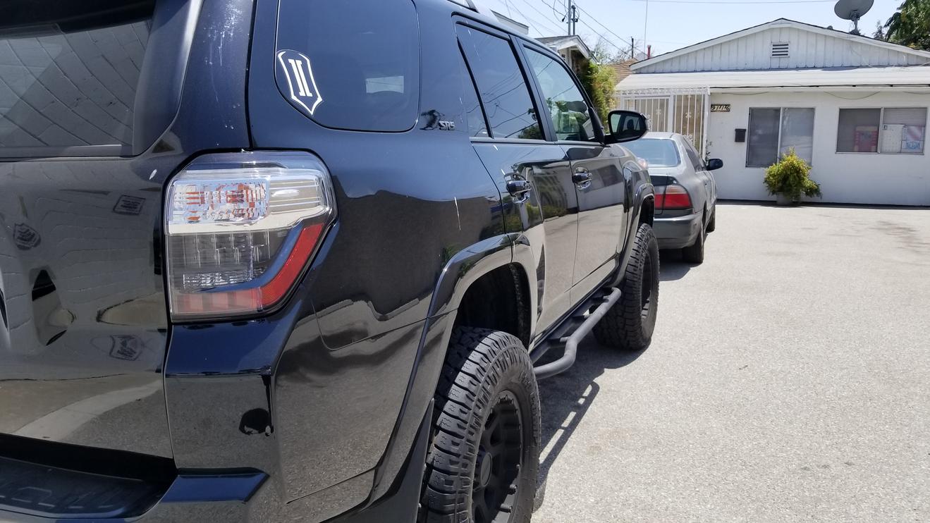

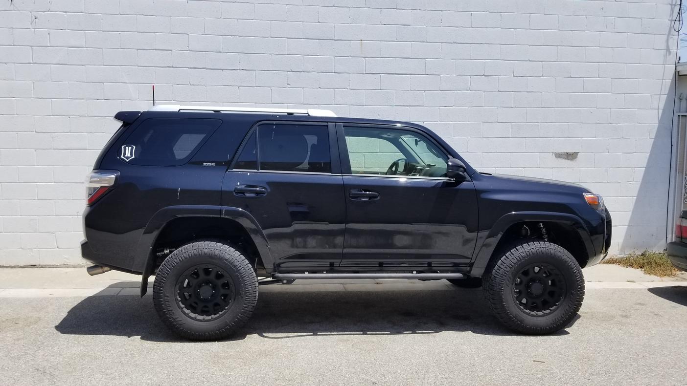

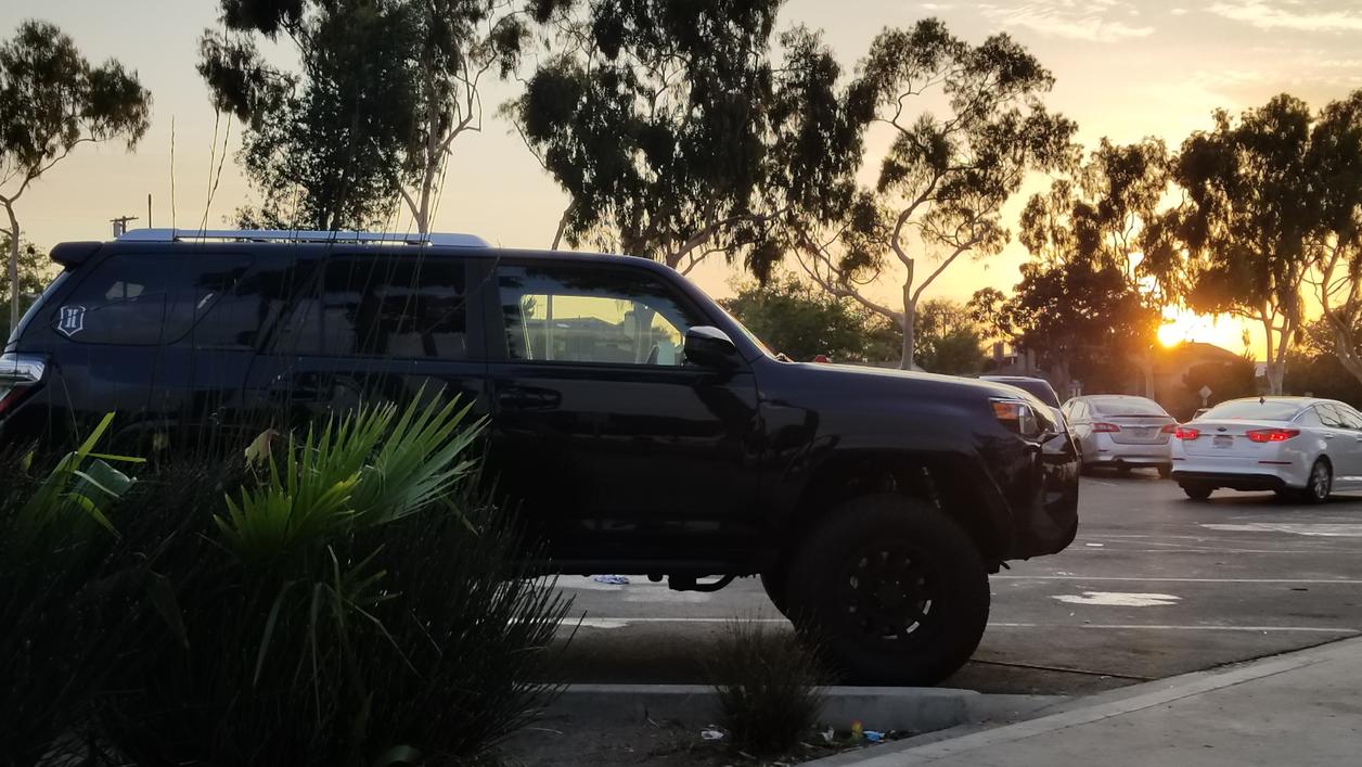

Finally got a set of sliders and went with the All Pro HD. I didn't want the top plate. They are pretty beefy.
